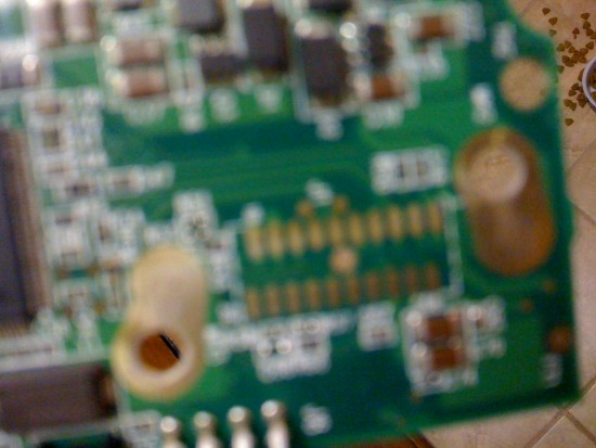

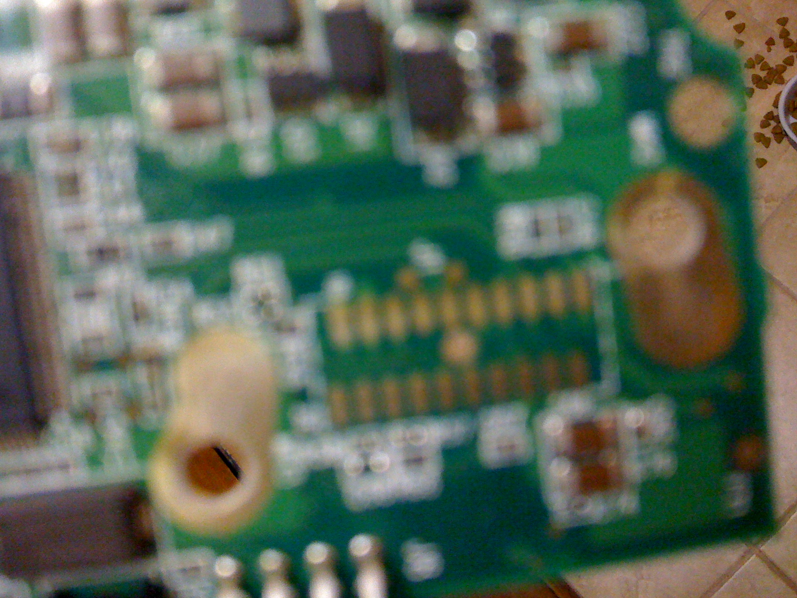

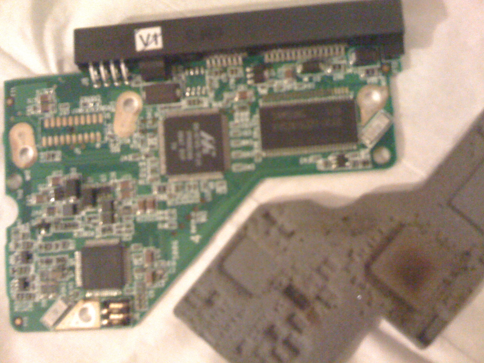

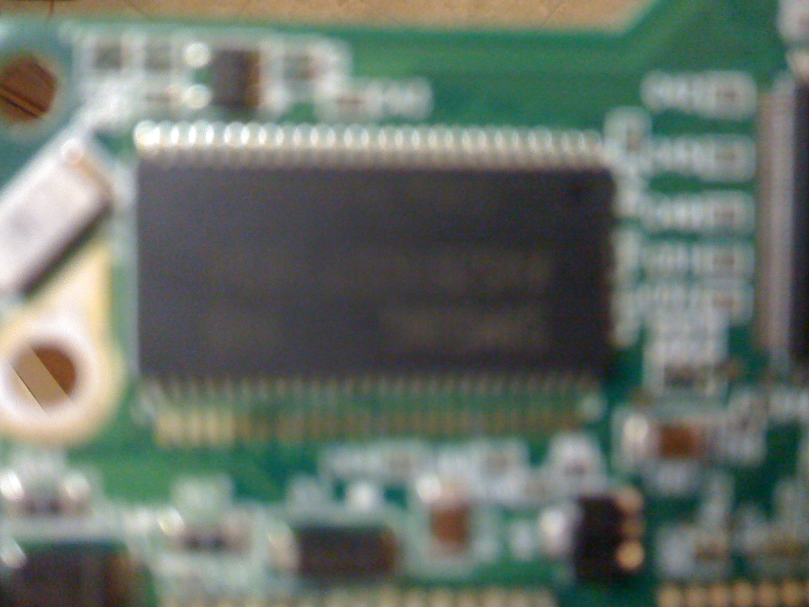

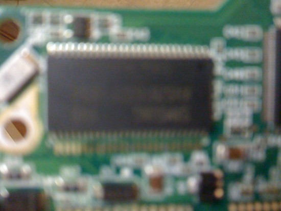

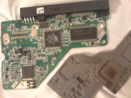

Attaching a picture of the PCB. There looks like there is rust or something on the other side of the pad that was insulating the board and the chip... It looks like some stuff may have gotten really hot with it there...
Any chances it's more of a PCB issue from the pic?
And also -- where is the TVS on this? Sorry for the blurry picture... iPhone is all I have.
EDIT: Added TWO MORE PHOTOS. It looks like there's some corrosion or burning... This makes me more certain that this could be the PCB's problem. How do I get a compatible PCB?
Thanks!

You can remove the oxide from the 20-pin preamp/voice coil connector in your first photo by scrubbing it gently with a soft white pencil eraser.
The TVS diodes are probably OK. You can see them in your third photo directly underneath the SATA power connector. The 12V diode is in the top RH corner, while the 5V diode is just below the midpoint of the power connector.
The following article should help you identify the components:
http://hddscan.com/doc/HDD_from_inside.html

Images are blurred from model this is tornado family. Test the PCB but it doesn't look like there's any external ROM on this board so sadly a PCB swap even if the motor is OK is a no-go.
