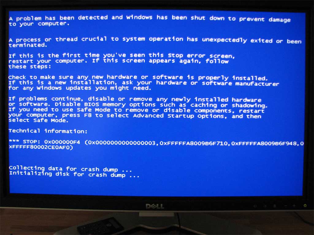

Hey all!
I've got an WD Raptor:
Model: WDC WD1500ADFD-00NLR5
Firmware: 21.07QR5
Serial: WD-WMAP41614947
LBA: 293046768

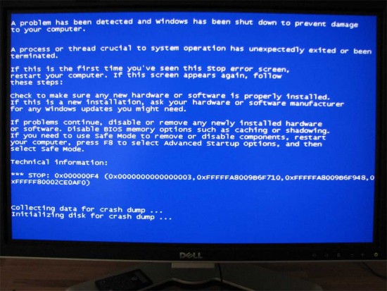

This drive ran under Win Vista 64-bit Ultimate and just stopped working from time to time giving a Bluescreen. I took a picture of it and attached it for you to see.

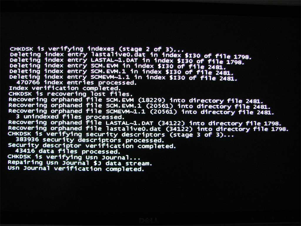

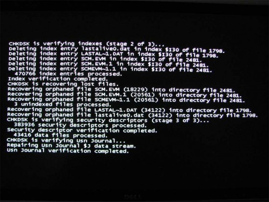

After this it ran Checkdisk and found a couple of errors. Attached the screen from this event to.
After this it happens again and this time it bluescreend and gave the same error .. and I tried to star in Fail safe mode. This worked until it got to the file CRCDISK.SYS then it hang again.
Now I have bougt a SSD-drive insted but i reconnected te Raptor and formated it. No errors, know I'm starting to worrie that there maybe is another error causing this behavior. Any hints on what causes these problems, or can I assume that the Raptor is the cause of the problem?

 Post subject: Re: Error on WD Raptor
PostPosted: February 15th, 2010, 13:01
Joined: April 10th, 2007, 9:53
Posts: 335
I wouldn't run any more chkdsk operations. You definitely appear to have some file system corruption. I'm sure one of the off the shelf solutions that are out there like RStudio, Runtime or something like that should help. Make an image of the drive first before you start the actual recovery.
PostPosted: February 16th, 2010, 21:10
Posts: 17232
199 UltraDMA CRC Error Count 200 253 00000000-0869 000
I believe UDMA CRC errors suggest cabling or communications problems between the drive and the SATA controller.
I don't know about Vista, but Windows XP downgrades the drive from DMA mode to PIO mode after it detects 6 CRC errors.
