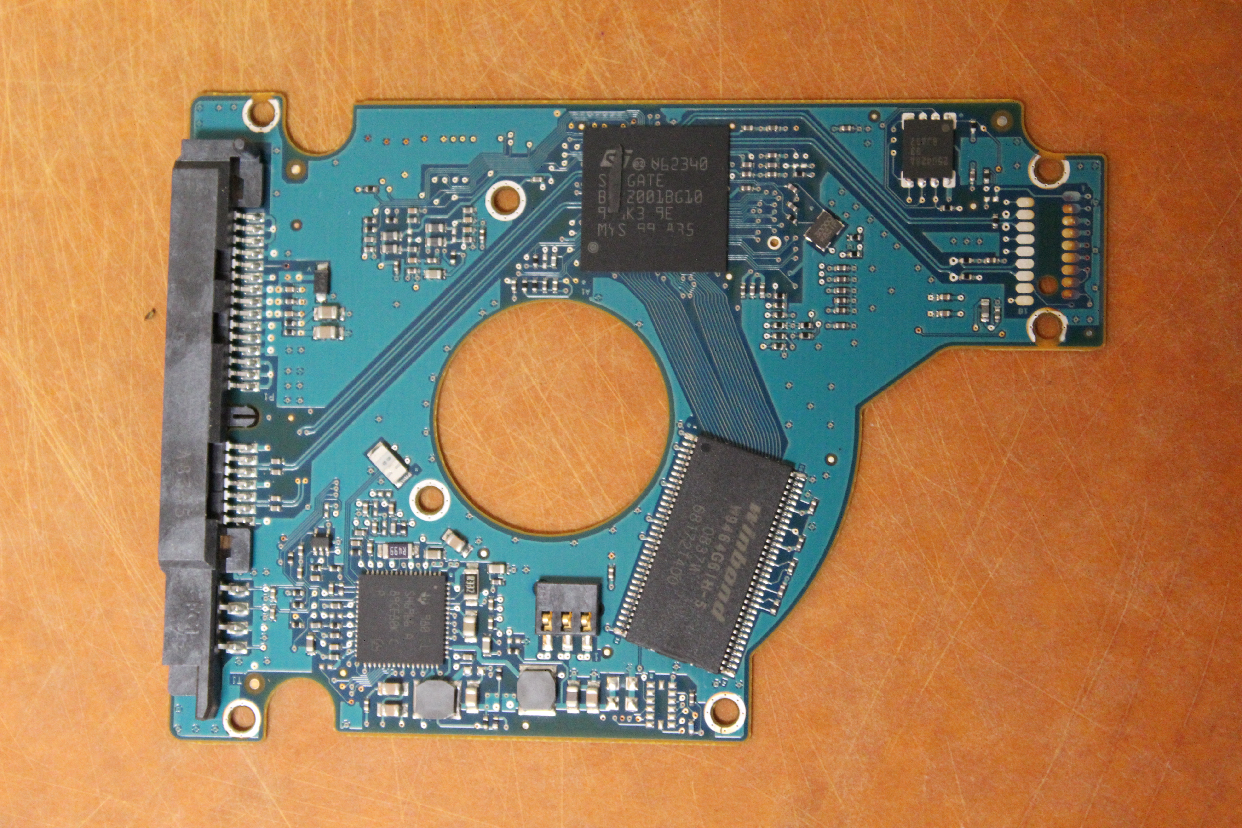

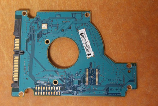

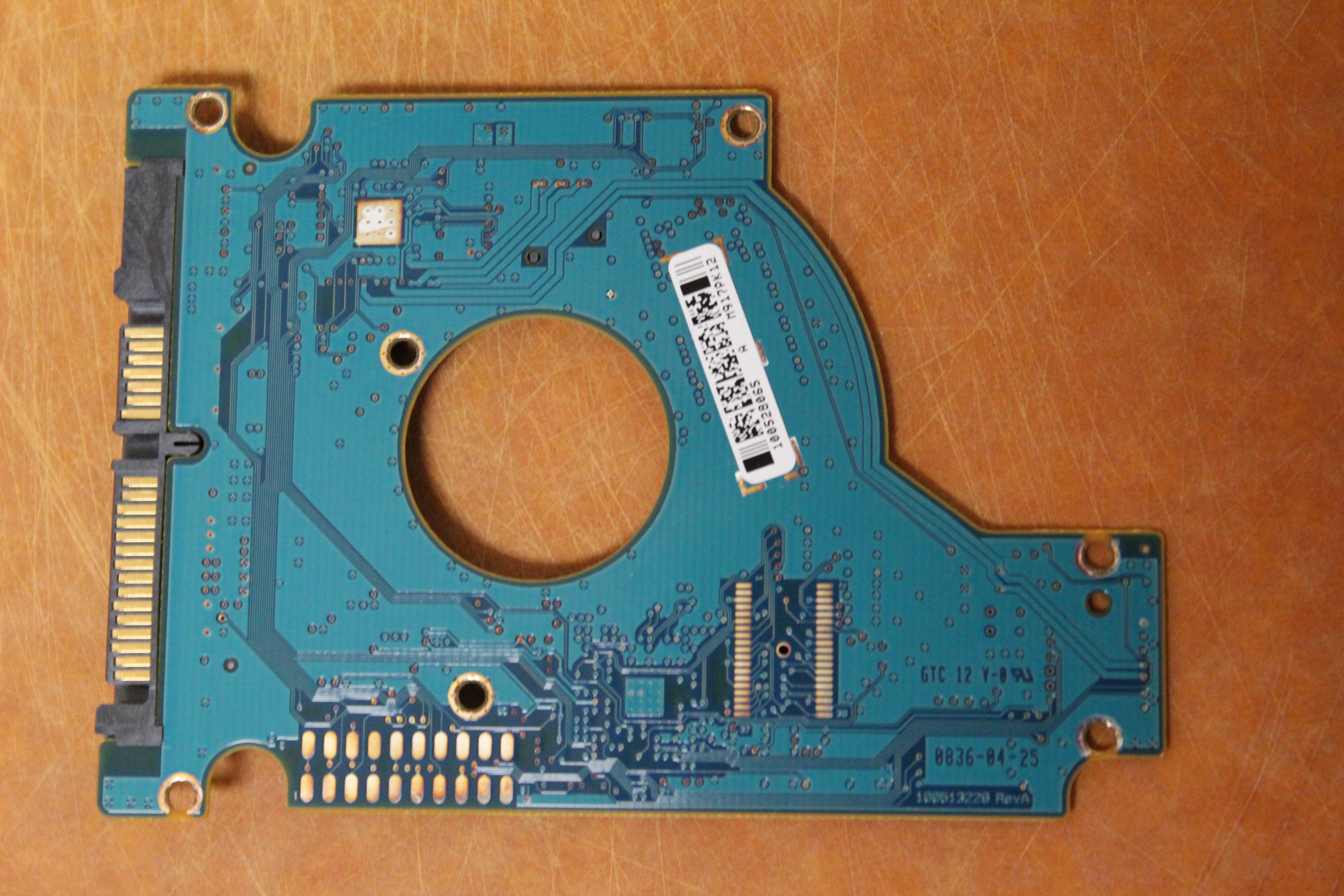

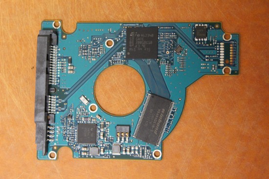

I have a Seagate Momentus 5400.5 320GB Hard drive that won't power on at all. No spinning or whirring when there's power attached - it's just silent. It doesn't show up in Disk Management on Windows or Disk Utility in Mac. I've tried different SATA enclosures, and will see the power on light from those, but always the same results.
Suspecting the PCB and since I coincidentally have a 500GB Momentus 5400.6 with a PCB that's visually identical, I tried to swap them to see if that might work. The drive spun up and made a few clicking sounds before Rosewill SATA dock displayed a red and green light and appeared to power down the drive. I'm hoping that means there's hope if I can replace or repair the correct PCB for this drive. I didn't see anything visibly wrong with the PCB, but have attached a couple pics in case someone's able to spot something I missed.
Full specs on the drive are as follows:
Seagate Momnentus 5400.5 320GB
ST9320320AS
PN 9EV134-566
FW:BS04
Date: 09357
Site: WU
I'd appreciate any suggestions.

ALL PCB's from this model (and indeed series) are absolutely unique, even the s/n is programmed into it.
You need to move the rom chip, which on this model is pretty tricky as its a nasty surface mount chip with a heatsink underneath, easily damaged.
