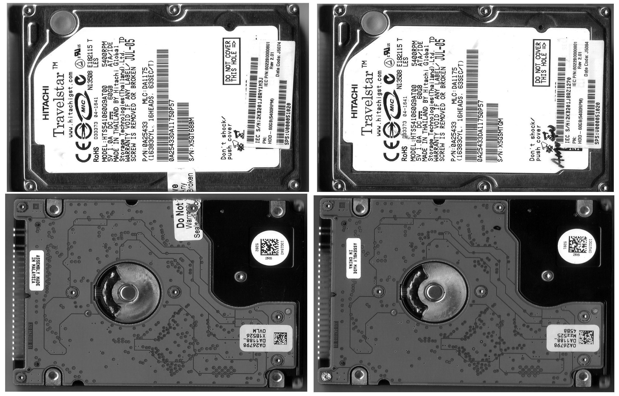

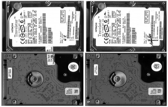

Here is an image of both drives..
File comment: Here is the image of the 2 drives, the one that has writing is the original drive...
 Post subject: Re: HTS541060G9AT00 identical donor, but shows errors with pcb
PostPosted: February 17th, 2010, 18:58
Posts: 17352
Can we see the component sides of both PCBs?

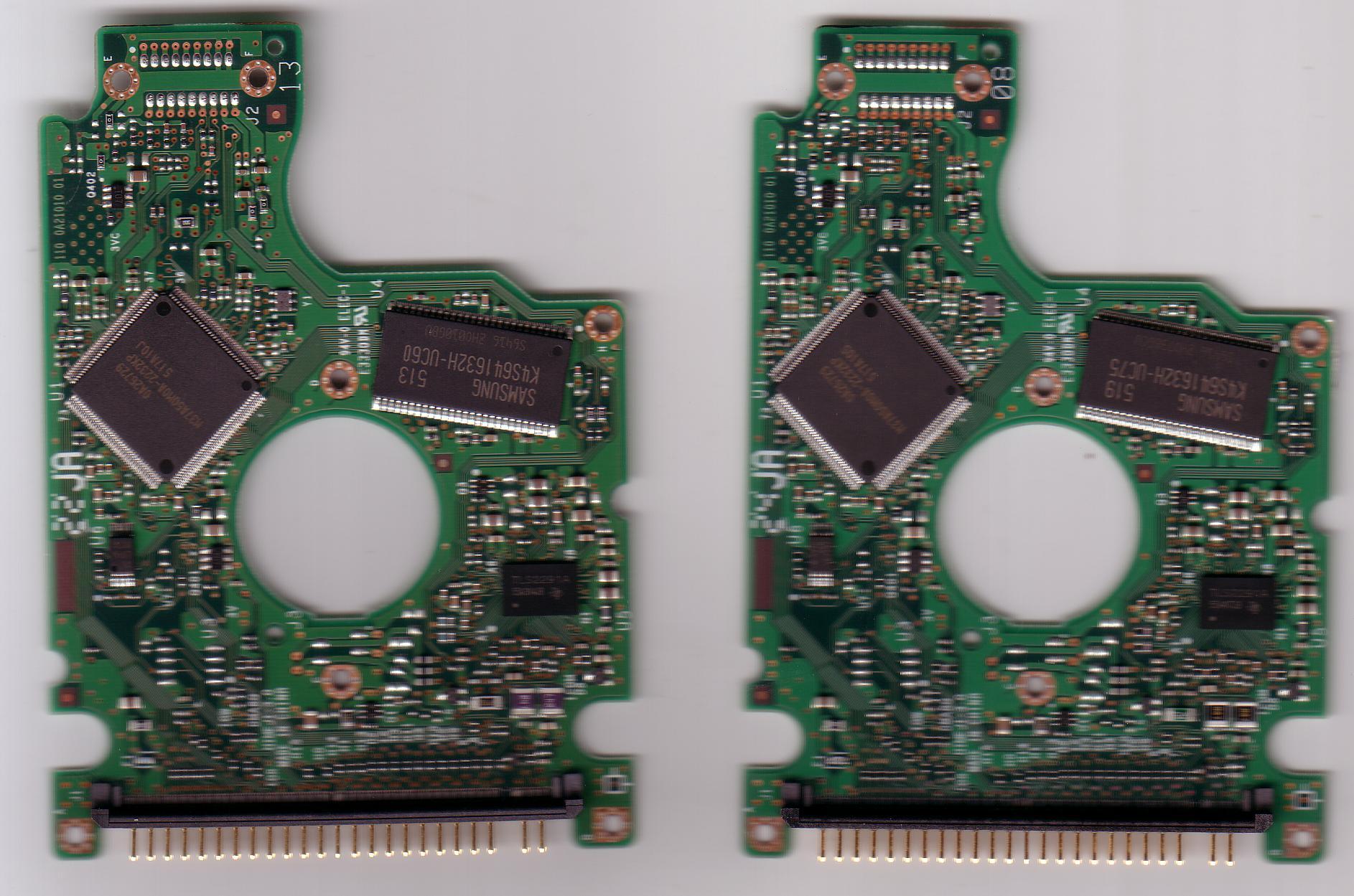

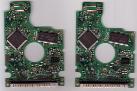

PostPosted: February 19th, 2010, 10:37
Joined: November 13th, 2009, 4:39
Posts: 51
Location: Panama
The one on the left is the original pcb and the donor is on the right side..
PostPosted: February 19th, 2010, 20:02
Posts: 17352
I'm not a DR guy, but I should be able to identify the ROM and NVRAM if you upload clear, detailed photos of the PCBs. If the other side has any components, please photograph it as well.
BTW, just be sure, does the drive spin up with the original PCB?
