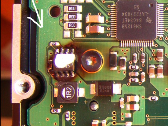

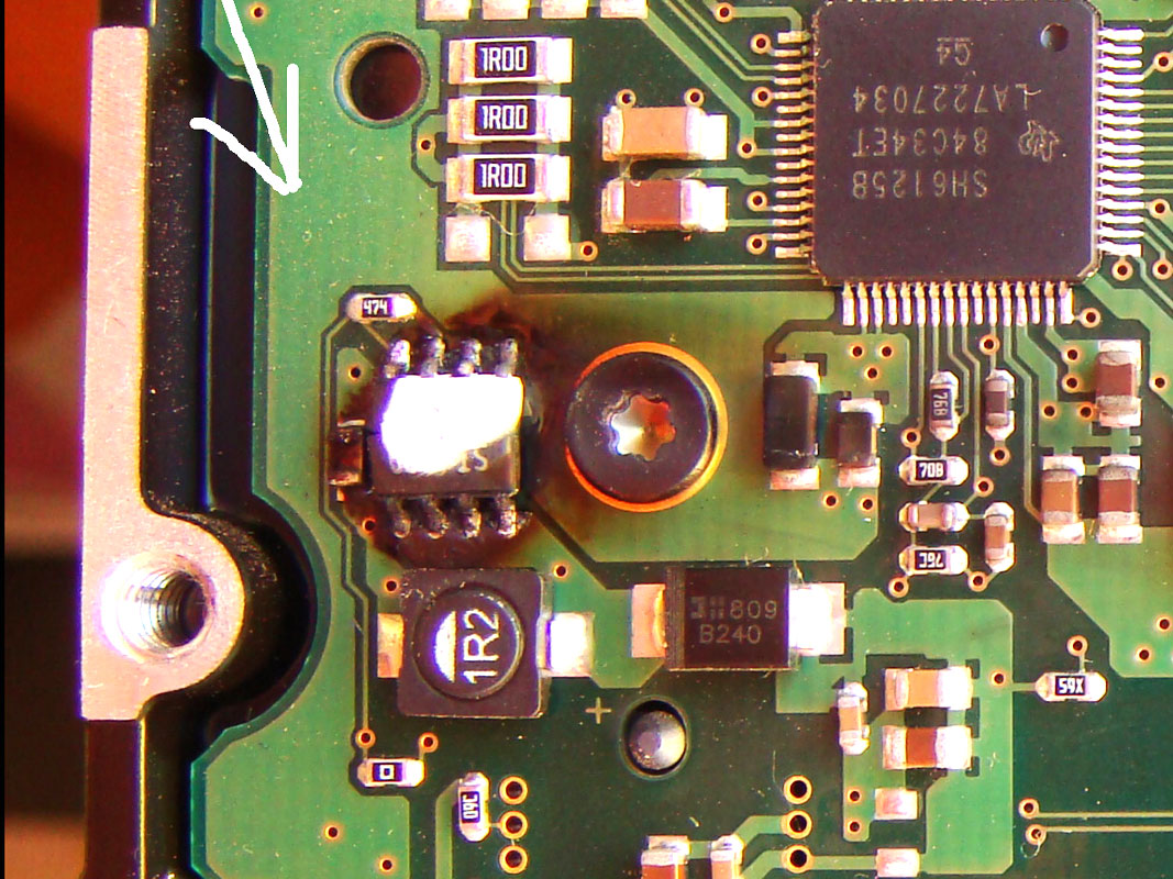

Hi everybody! This is my first post and I would like to share a solution to recover my PCB and data soterd on my hdd.
The TVS Diode is short and I remove it a long time before, but now I have a problem on my drive as you can see on pics posted below

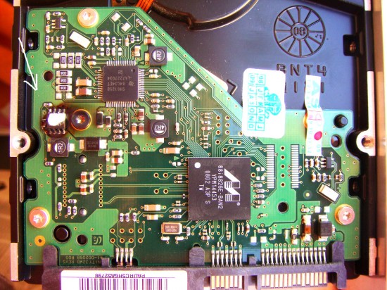

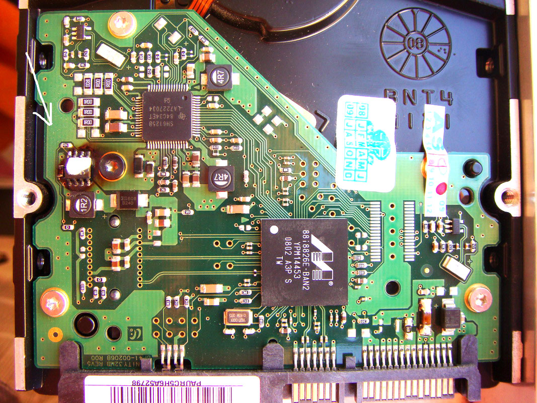

Post full picture of your pcb then we will tell you where ROM is .

OK, I'm not shure it was a ROM chip. I think that its an voltage regulator.
What chip can I replace for the fried one ? It was ST... (model was fried)

 Post subject: Re: SAMSUNG hd753lj with fried ROM -Please help me to solve it
PostPosted: February 21st, 2010, 23:58
Posts: 17352
That could be a MOSFET, or a switchmode regulator that incorporates a MOSFET.
The flywheel diode is a B240 Schottky.
B240, 2.0A, 40V, Diodes Inc, SURFACE MOUNT SCHOTTKY BARRIER RECTIFIER:
http://www.diodes.com/datasheets/ds13004.pdf
The mark on the chip looks like a dab of paint or liquid paper. I don't think I've ever seen a chip fail that way.
That particular regulator appears to supply the negative voltage for the preamp.
What was the failure symptom?

It stopped to be detected by BIOS and when I remove it this chip on PCB was fried.
I can do repair on this PCB. I will put my progress here and all help will be welcomed

Here is a datasheet, with application circuits, for a typical motor controller chip:
http://www.datasheetarchive.com/pdf-dat ... /28826.pdf
I would check whether the preamp is shorted. This could take out the negative voltage regulator. Follow the bottom end of the 1R2 coil to the 20-pin preamp connector. I believe that should be the negative rail. The ground should be easy to find.

See this photo:
download/file.php?id=1386&mode=view
The mystery part is an STJ009 MOSFET.
STJ009, 30V, 5A, P-channel Trench MOSFET, AUK Corp:
http://www.lintry.com.cn/spec/17/STJ009.pdf
