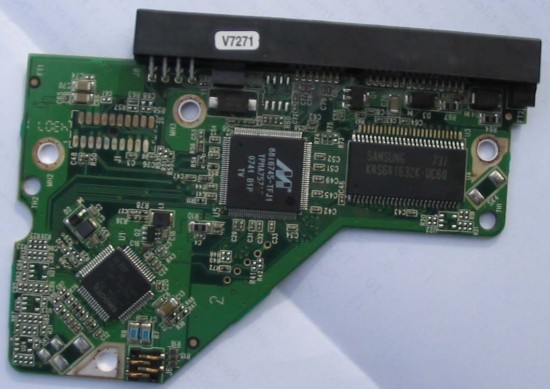

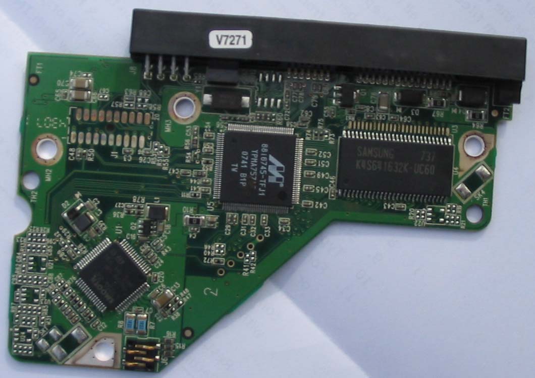

I am very certain that you will not be able to get this drive up and running on your own; You will need special tools for this. I am guessing that this drive has the L shaped PCB, and that there is no U12 chip present. If there is a U12 chip (should be 8 legged chip) then you are in luck, and what you need to do is transfer the U12 to the new PCB (Take careful note of it's orientation, often there is a key to help you)
and that should do it, unless of course the preamplifier (a chip located inside the drive on the headstack) has been damaged as well. At that point you will need expert level experience, and equipment/facilities.
If there is no U12 you will need the special tools; you will likely need to rebuild a new ROM because the ROM will be inside the CPU which is what you are describing as damaged.

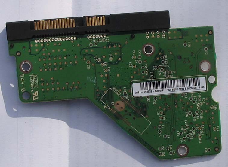

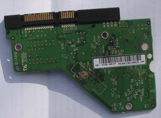

Also, I'm fairly confident that everything but the PCB is fine (since the replacement PCB I tried sounded just fine) but should I be trying to locate a similar board BEFORE going to a repair expert or just let them pull off the data and throw away the drive... did I mention that it's my wife's stuff and there's not much of it but she is not a happy camper?
Pictures attached.

Your PCB only need a (washing machine) , nothing else.
XRONIS
Yes, contacts look a bit overused, but most likely that is not the problem. You can try to clean the contacts and try again. Maybe you get lucky. But since this happened after the power cable issue, more so realistic is the theory that you have some damaged components due to over voltage. If you know electronics and have a multimeter you can test out the board. Assuming of course you have a good multimeter and assuming you are good with a soldering iron. This of course would also require you to replace any damaged components and some components can not be properly tested with just a multimeter. Which would bring you back to square one. Yes, this board has the rom inside of the MCU ( IC chip). Yes, more or less a copy of the rom content is also available via SA. But it's not quite that simple and again you would need some professional equipment and some experience to perform this.
Therefore In my opinion your best choice is to send your drive to a pro.
