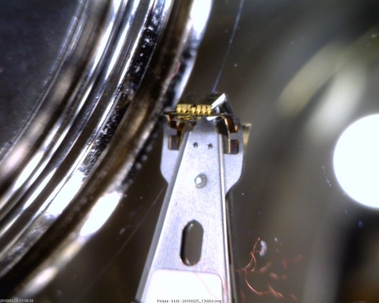

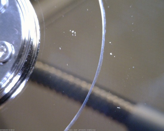

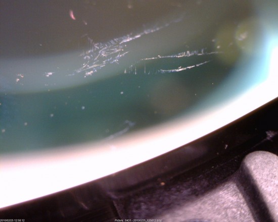

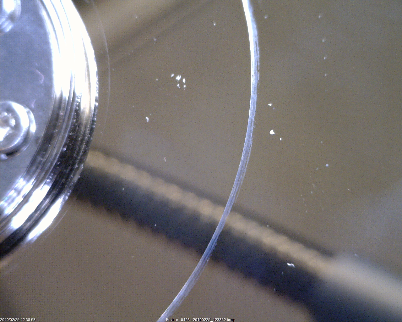

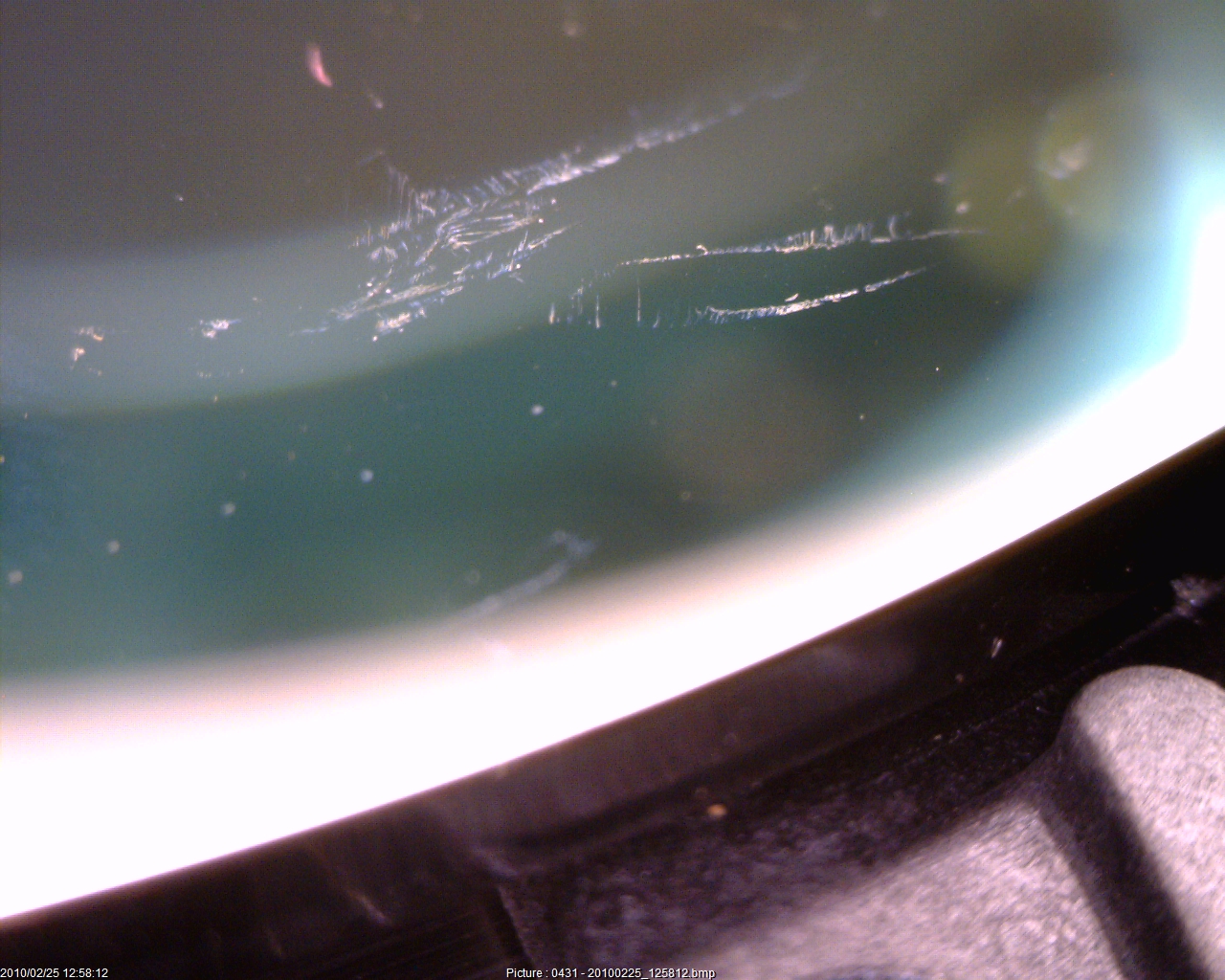

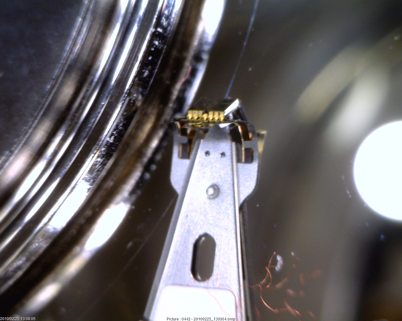

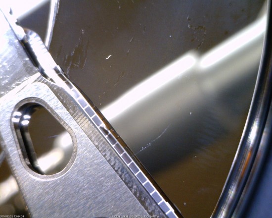

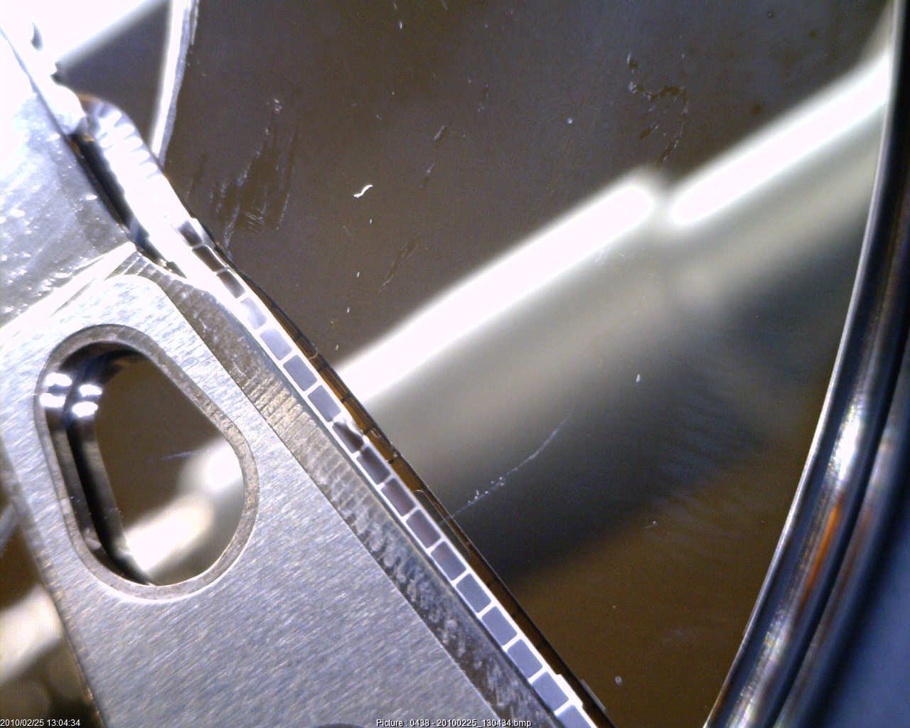

Im know a lot of people read this forum , so i want to share this
Many times u heard posts with answer to u question " dont tried send to a DR company", an attempt to do it by u self could be risk for u data etc, well , this is the reason why many guru´s insist u dont tried, we receive this day Seagate 500Gb 7200.10, people who looks doesnt have experience and without proper installations , tried to did a DR here, causing, contamination over surface, MR heads broken, and a lot of dust when they tried to put again, damaging directly to the platters.
So now u know consequences if u really want to tried by u self!
 Post subject: Re: Consequences of DIY
PostPosted: February 25th, 2010, 20:42
Posts: 872
Location: Dublin
Hi Beto, good idea to show this, maybe this topic should be made sticky so that the DIY'ers can see what happens when they screw up. We see this situation so often, fingerprints, dust, bent MHA, even biscuit crumbs :)
Then they send a drive to us and actually sound disappointed when we can't fix it!! Customers eh :roll:

Wow, thats a bad one. I was working on one today that someone tried a platter exchange and I'm pretty sure they put them back in the wrong order :roll:
