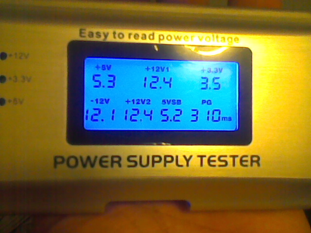

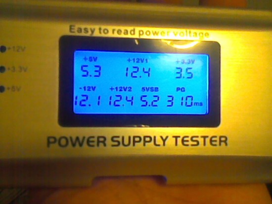

 Post subject: Re: Need Help Diagnosing Issue with Seagate ST3750330AS
PostPosted: March 23rd, 2010, 6:05
derek0606 wrote:
What should I do to check my power supply; should I hook up a voltage meter to the connector i was using?
A bit too late now... something like THIS and a load on the rails to test under working condition.
This is a crap PS (look at the values) in fact was signalling the failures when measuring.
P.S. common 10$ multimeters and without a load won't give exact reading. I have calibrated PROFESSIONAL instruments and - strange but true - this tester , if 0,1 V precision is sufficient, seems accurate. The PG measurement is accurate too. Sometimes happen :)
PostPosted: March 27th, 2010, 19:55
Joined: March 2nd, 2010, 15:12
Posts: 5
Location: Houston
