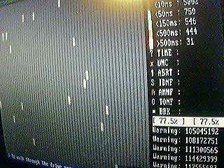

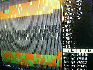

I don't know... all three drives read sectors OK for the most part. The write head or preamp seems to be malfunctioning. This is a Hitachi HTS541080G9AT00.
Here is where I used MHDD's ERASE on a few million sectors and then scanned those sectors:
This section of the disk is where I haven't used ERASE:

Sorry, couldn't figure out at first how to upload images.
If I ERASE the second clean section, it will look just like the first one when scanned.
If the write head can become damaged independently of the read head, then only a head swap could fix it, but if it is a repairable problem in the write preamp circuit somewhere, then these three Ptaak hard drives could have their honor restored and be reformed into warriors again.

We encounter a fair number of Hitachi J9SA00 series drives, mostly in laptops. The prevailing pattern for these seems to be one bad head, along with a lot of bad sectors under the failed head. A failing write head would explain the data corruption.
In the subject drives, the corruption often begins around 400K sectors into the drive, which is where the directory resides for the operating system. Changing heads in this scenario doesn't seem to help, in that the underlying sectors are still corrupt.
There are other cases where the READ head fails, where changing heads definitely helps.
We have had some cases where a bad read head will spontaneously "heal" during imaging, and most all of the bad sectors will come out as good. I suspect that either the head is dirty, or else the process of thermal recalibration allows it to find the "sweet spot" once again.

It's highly unlikely that your drives are experiencing any problems with the preamp. If the bad sectors are logical then you can repair them with MHDD. read the FAQ. If they bad sectors are of a physical nature then you either have a weak head that is becoming faulty or as the colleagues suggested some media damage. If you can't repair the bad sectors(logically) then you should consider tossing the drive in the bin. Even if you would attempt to swap any parts or other measures to vitalize the drive you would never get the drive stabilized to function properly again. Hard drives are complex mechanisms and they are not designed to take apart and repair. Therefore any attempts to repair physical failures on a hard drive are to temporarily stabilize the drive to salvage data from it.

This drive gest some hit before, and the particles are in the head.
You will never repair this drive, you should clean the heads, and replace the platter for drive repair.....
This is not worth it.
