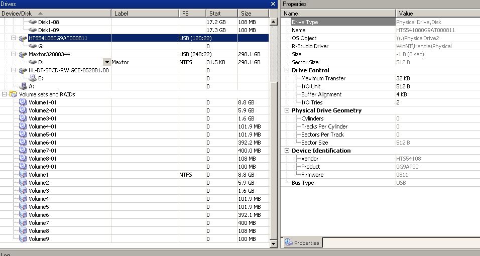

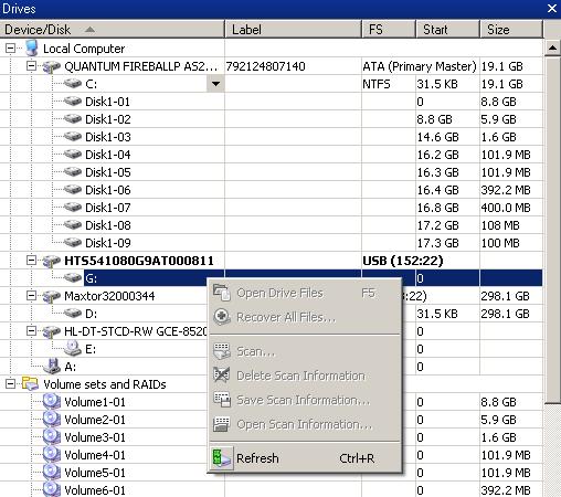

My screen shot from the r-studio program is just like on the screenshot.(attached)
The one I want to recover is HTS54....
There is no recover delete or scan option is available when I right click.
Unfortunately I am not a good tuneman. But I am sure you can help me.please.

Hi
r u following wrong procedure i think select u r Drive Right click select Scan Try Simple scan it is faster procedure if u can't find Proper Data Try again with Detailed scan u will get Results.

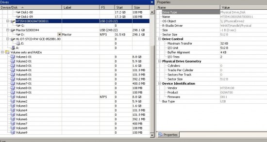

hello
I cant even click the scan option it is disabled. as you see on the screenshot.

Location: Toronto
dont click on the assigned letter. Right click on the drive itself. So right click on HTS541080... etc, choose scan option.

Posts: 1493
the disk is showing as no capacity. either your usb connector is not working or the disk has a serious failure. Is the data important? if so stop what your doing now and get yourself a quote for data recovery. try pcimage on this forum.
the scan option also not available on the "HTS541080..."
so in both case disabled.

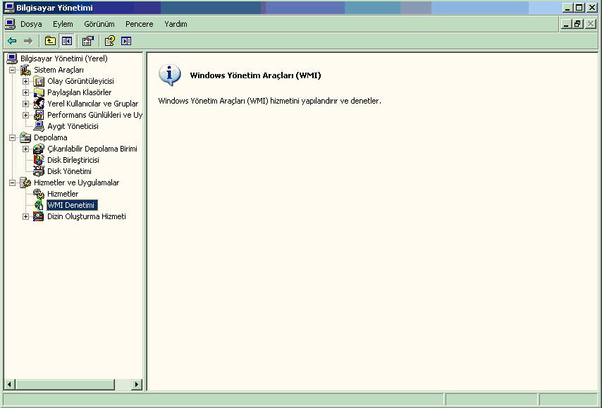

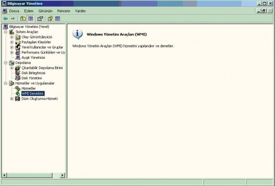

What does it show under WMI disk manager (Right click My Computer, select manage, then select disk drives)
https://www.mjm.co.uk/
 Post subject: Re: HITACHI HTS541080G9AT00 / 80GB Please Help
PostPosted: March 7th, 2010, 5:28
Joined: February 28th, 2010, 15:31
Posts: 7
Location: London
The screenshot from WMI Services is like this.
Do you mean by right click or?
