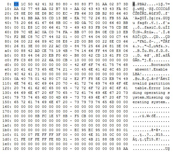

Can somebody identify this sector, to know what is the drive encrypted with ?
Picture in attach.
File comment: Sector view

http://www.securstar.com/products_drivecryptpp.php

Sure?

no, but http://board.gulli.com/thread/921572-dc ... niability/
