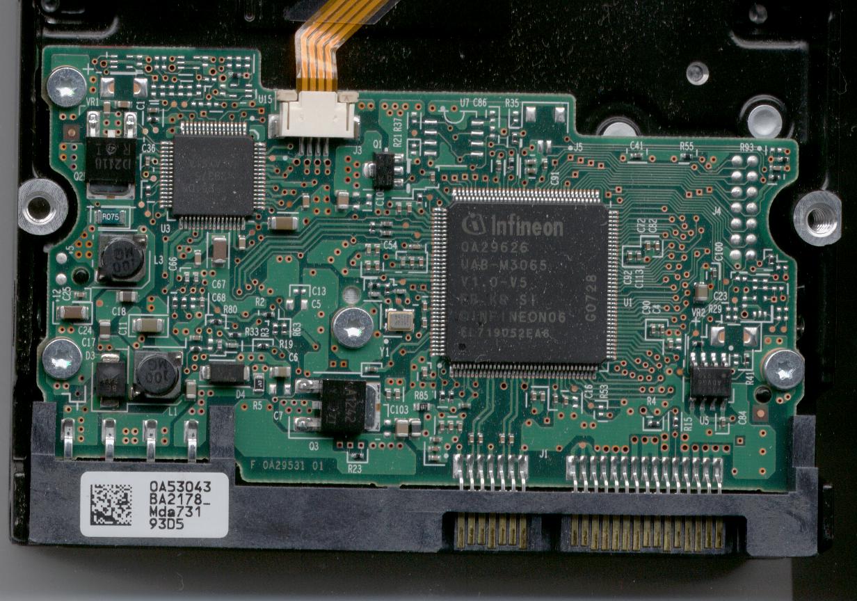

Looking for the controler board on the drive, mine has a cracked chip on it.
Model:HDT72505VLA380
P/N: 0A33422
Number on board
0A53043
BA2178
Mda731
93D5

Post a picture of you pcb .

You can remove it and get back your data it is a TVS that is cracked.

Hitachi preamp is really sensitive for power spike, and this model have only TVS in 12V line.
I suggest to check the preamp first before powerup the drive if you want to avoid data area damage...

Thanks for all the help, I removed it and was able to access the data,
