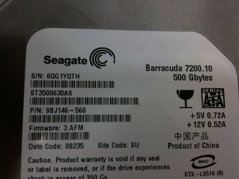

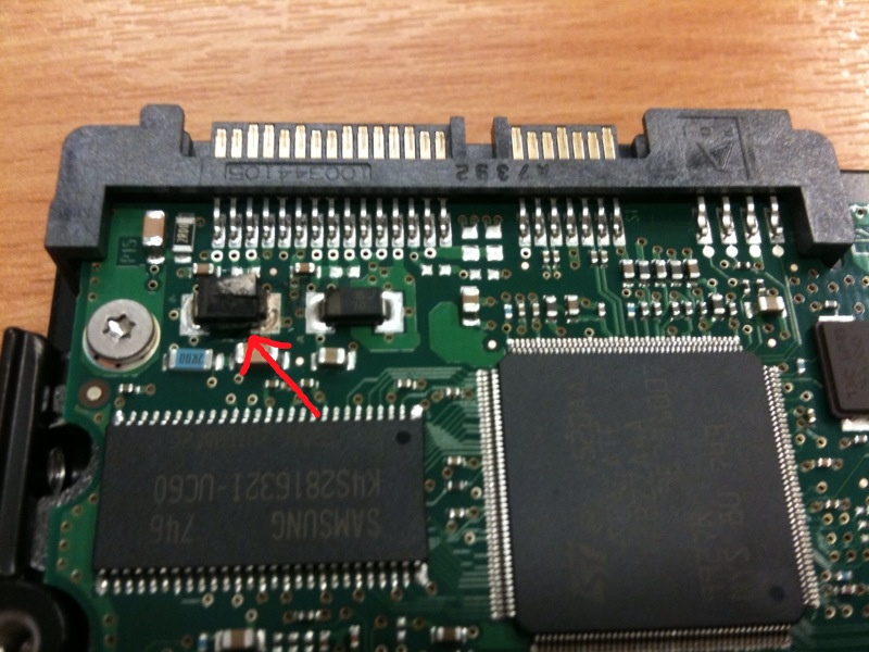

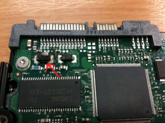

Was in a Maxtor caddy , doesnt spin up
discolored/cracked chip.
I have a ton of ST Drives, any probability in swaping these chips?
what needs to match?
thanks in advance
andy

it smells a bit too :)

It is a TVS... Lots of threads about it...
Just take it off, recover data, replace drive.

in ur search ull see. 2 options. replace it or jump it. Gl m8. Hopefully only TVS died and nothing else.

im on it, pulled the bugger off (with the grace of a butterfly) , just going to plug it in , fingers crossed

alexii, cleanroom
From the bottom of my scottish heart......... :D
THANK U !!!!
