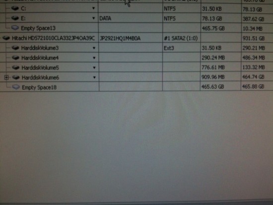

I have had 2 samsungs in recently and a raw recovery is poss but a structure is not possible any way I image it or scan it.
R-studio only finds extra files, I passed it to someone else who got the complete structure.
The drives have been fine and only corrupted
any ideas
thanks
andy

You tried other DR software?
Sure it's in NTFS/FAT/UFS format? Not XFS or something?

Sorry for delay in replying to this, I was waiting on a DDI.
Problem persists after a clone, the File system was NTFS, images no problem but the partitions are not visable.
After a scan with r-studio all you get is "extra files" , files are good but in no structure.
here is a screenshot from r-studio, basically logical corruption , any way round this?
thanks
andy
Drive HD501LJ/JP3 Samsung

Try GetDataBack and compare your results....

doesnt look at it, already been there.
might try the general option, i was trying to be clever and being specific
