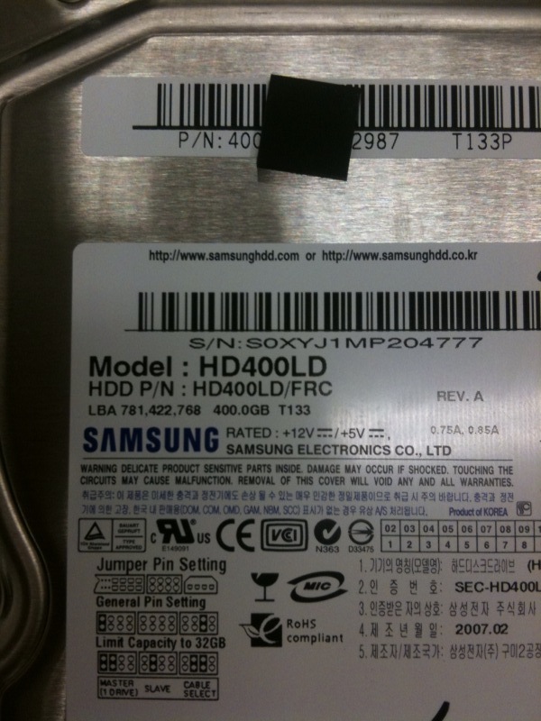

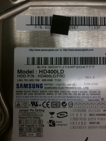

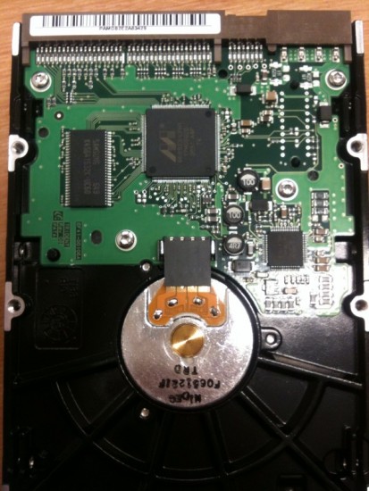

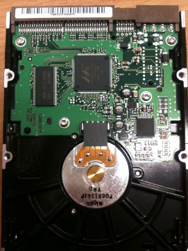

Any ideas, any chance this is TVS? or something more sinister
just died apparently
thanks
andy

no visible damage

got a multimeter?
 Post subject: Re: Dead Samsung HD400LD no power
PostPosted: March 25th, 2010, 16:48
If you have, then check the two large-ish black rectangular components top right.
They should NOT be short (simplest method use the continuity meter mode on the MM).

This thread may help:
http://www.mikrocontroller.net/topic/58330
One of the two TVS diodes is circled here:
http://www.mikrocontroller.net/attachme ... 400LD_.jpg
There appear to be fuses in series with each diode. If a diode is shorted, then remove it. If a fuse is open, then replace with a 2A picofuse, or bridge it with a wire.
Be sure that your PSU is OK, as you will no longer have any protection after doing the above.
