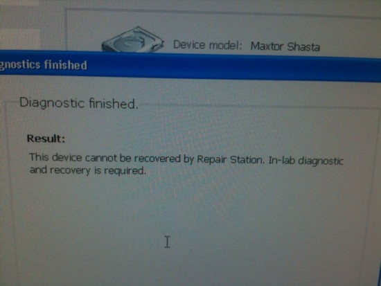

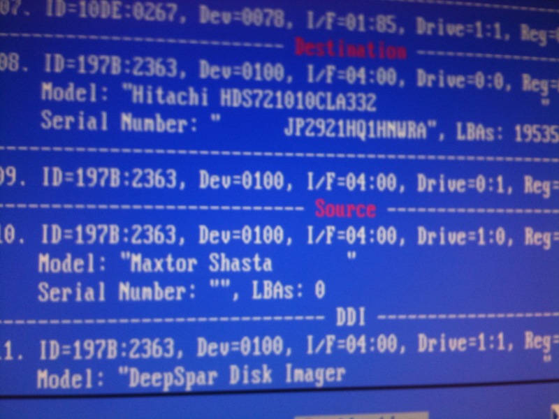

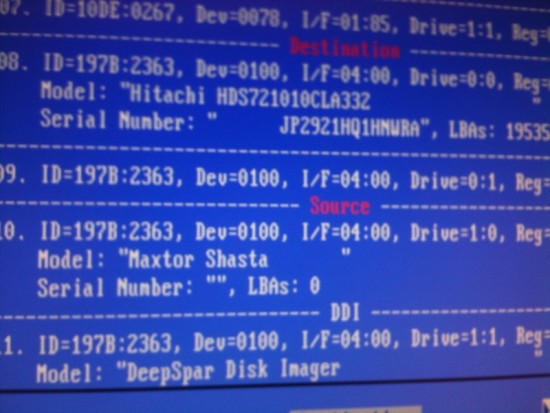

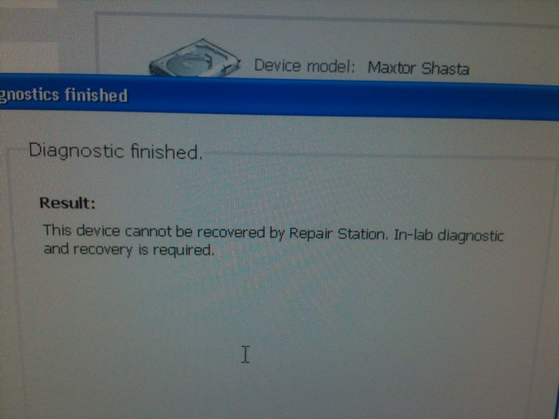

 Post subject: A Possessed Maxtor
PostPosted: March 25th, 2010, 16:29
Posts: 248
Its ment to be a IDE DiamondMax 17 160GB 6G160P0
But today it thinks its ........
Apparently it was dropped.
any ideas?
andy

It's got at least a FW issue and probably head and/or platter problems, that's its factory alias.

Drive is recognised by family name. If you have the right tool (atola/pc300 etc) post an SA report (If the drive will reach a ready state).
0 LBA means you have no logical data access.

Thanks guys, thought it was FW but didnt know that was the family name, "every day's a school day" :)
dont have those tools, saving for an atola portable

In this case not much can be done without correct tools/knowledge. I'd try not to run the drive at this point, if your client needs data then it will need specialist attention.
Dropped drives are never much fun :( (especially if running!)

If its dropped I would say its a head problem. Hopefully you havent been running it for long.

Its seems Firmware issue because 0-LBA PROBLEM SHOWING WITH FAMILY.
need good tool to fix firmware for data recovery :D
