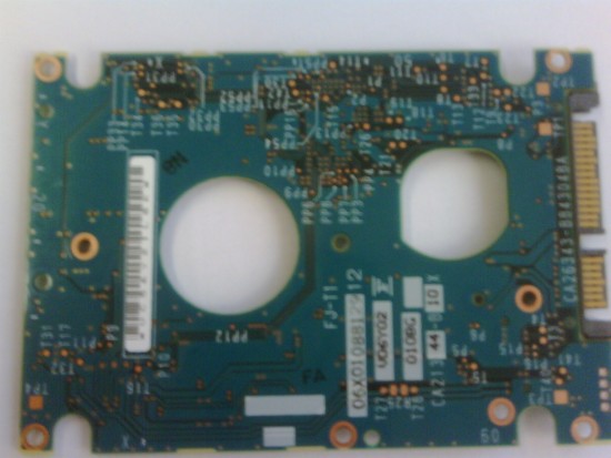

 Post subject: Fujitsu MHW2080BH PCB,how to look for same PCB with same fla
PostPosted: April 6th, 2010, 3:58
Joined: January 25th, 2008, 1:57
Posts: 48

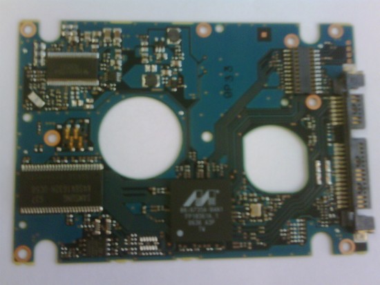

all HDDguru, Fujitsu MHW2080BH PCB fire up,flash rom on PCB is lost now, how to look for same PCB with same flash rom ?

after refresh the rom chip file on another good PCB ,start to click when power on , I think need to replace the disk heads with the donor disk
oringnal PCB ,main chip 88i6735A is burn (I think) feel hot ,motor didn't trun around,rom chip lost
 Post subject: Re: Fujitsu MHW2080BH PCB,how to look for same PCB with same fla
PostPosted: August 24th, 2010, 11:13
Joined: August 24th, 2010, 11:07
Posts: 15
Location: Hong Kong
My PCB has problem too, I just replaced it with the same PCB.
However it doesn't recognize the harddisk as the firmware is different.
CA06820-B128 firmware needed 07FFAA-0000001C
My new PCB using newer firmware, how can I flash the firmware into the flash?
Please help
PostPosted: August 25th, 2010, 3:19
Posts: 17352
What was the problem with the original PCB?
Can you upload a detailed photo of the component side?
PostPosted: August 25th, 2010, 4:37
Joined: March 26th, 2010, 4:36
Posts: 45
Location: somewhere
With a flash programmer or special factory commands
You can also try to fix the original pcb as fzabkar suggested or you can swap the ROM to the donor pcb if you cannot flash it.
PostPosted: August 25th, 2010, 7:42
Posts: 15
Location: Hong Kong

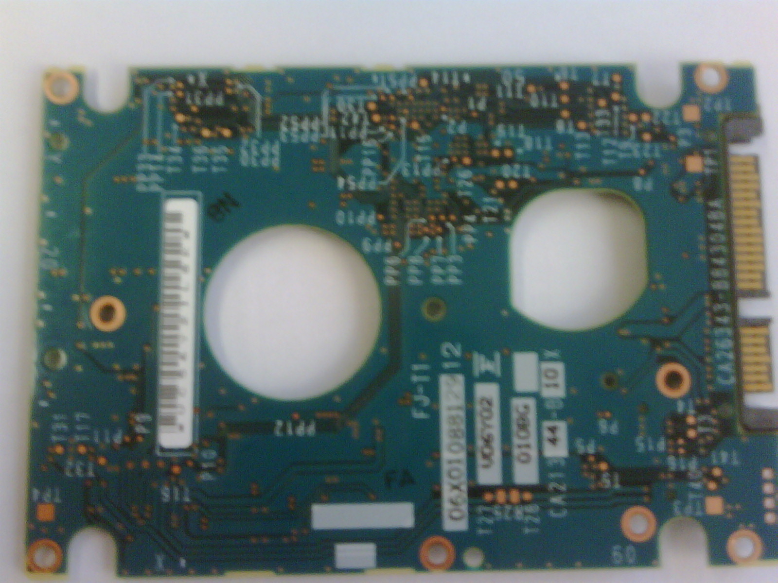

My original PCB wasn't able to get power, no electricity going through all the TP1-TP6.
For ROM swap, I don't know how to locate the ROM on the PCB.
PostPosted: August 25th, 2010, 18:18
Posts: 17352
Photo please.
PostPosted: August 30th, 2010, 8:03
Posts: 15
Location: Hong Kong

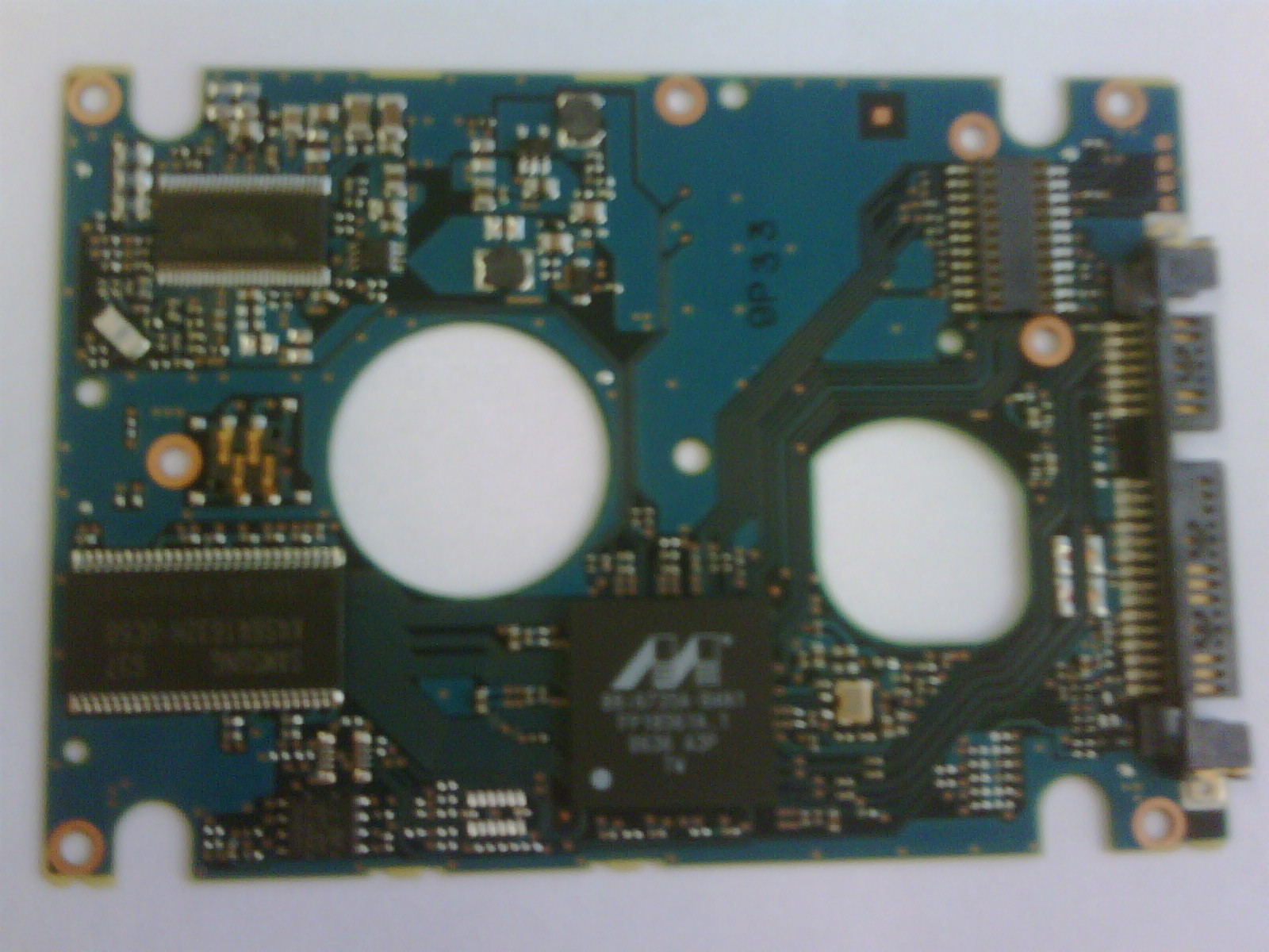

attached the front and back of the pcb
File comment: back
File comment: front
PostPosted: August 31st, 2010, 8:13
Posts: 17352
What are the numbers on the chip below the RAM and to the left of the Marvell MCU?
I'm looking for a protection device near the SATA power connector, but your photos are extremely unclear.

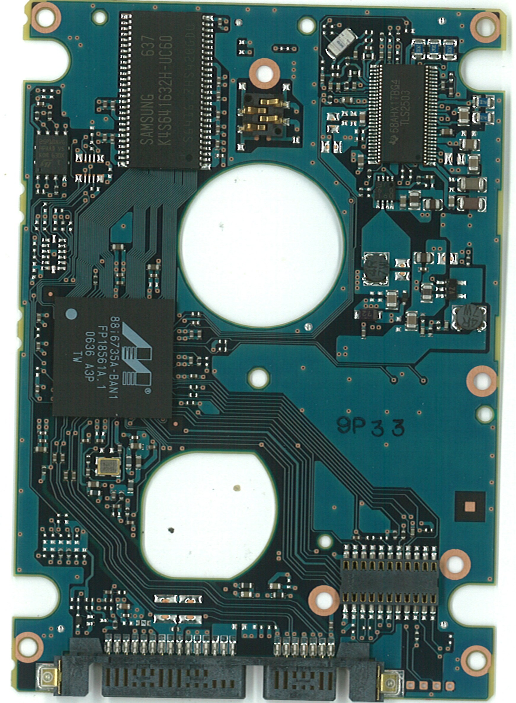

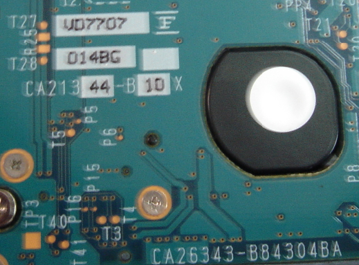

No problem, I use the scanner to scan it for you. You will see the detail after magnifying with the scanner.
PostPosted: September 1st, 2010, 22:21
Posts: 15

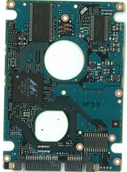

Location: Hong Kong
better screen
PostPosted: September 1st, 2010, 22:34
Posts: 17352
Thanks, that's great.
However, I can't recognise any protection devices.
The chip at the bottom LH corner of the Samsung SDRAM is the EEPROM (p/n 25P10?V?).
Good luck.
PostPosted: September 5th, 2010, 21:12
Posts: 45
Location: somewhere
There's a component in your picture at the bottom near the SATA power connector marked with an "N". That's the fuse. Make sure it is not open. Another option is to swap the ROM to your donor PCB.
