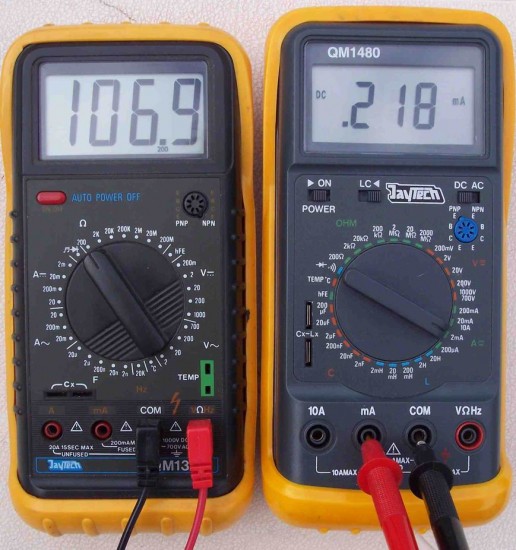

Both my meters (AU$70 and AU$100) use 1mA. I've buzzed hundreds of ASICs in all manner of equipment without any damage. I don't see why HD preamps are so special. AFAICS, even the sensitive (?) front end needs to be able to handle the 6mA (?) bias current for the GMR heads. Of course, that would be with power applied. Not quite the same thing ...

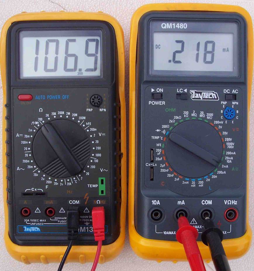

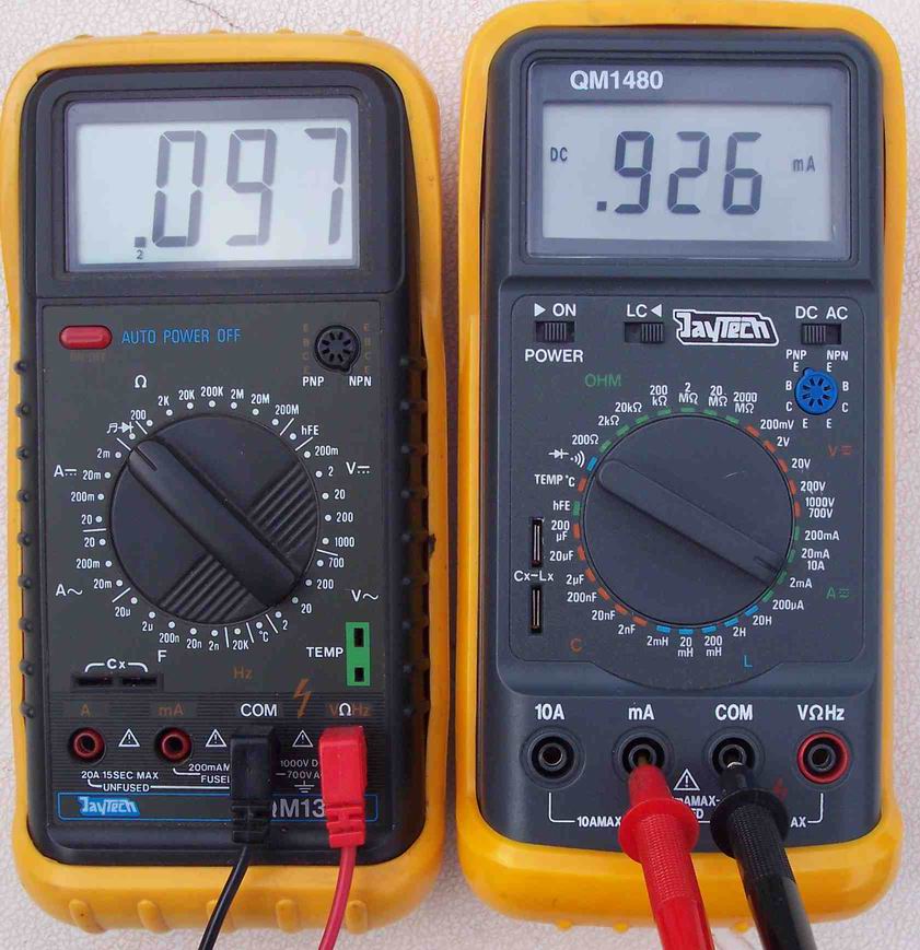

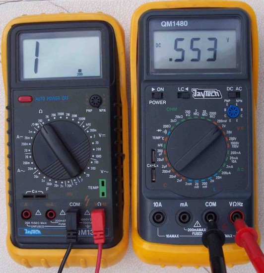

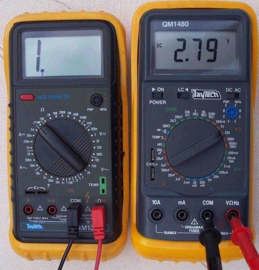

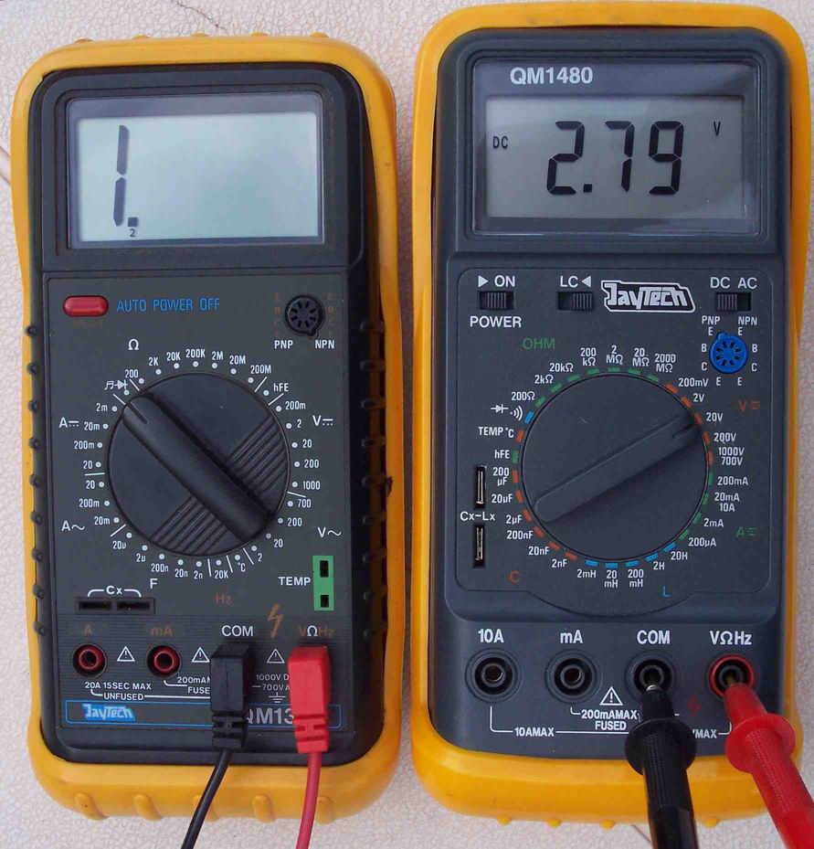

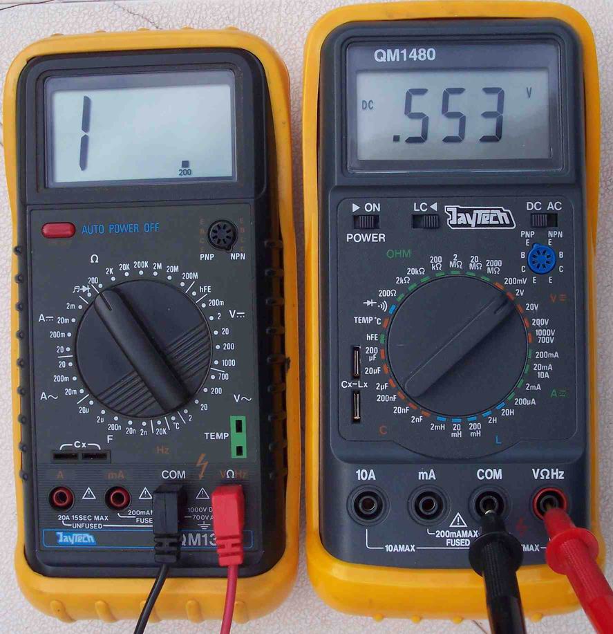

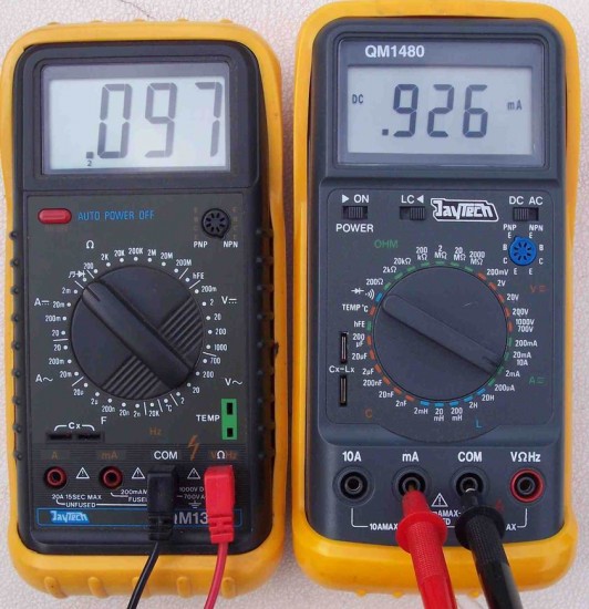

Well, I think a week is long enough time to wait for a stallion to perform. :roll:
The photos are here:
http://www.users.on.net/~fzabkar/DMM_test/
If you need any help understanding the procedure, feel free to ask.
BTW, I paid AU$70 for the QM1320 meter about 10 years ago. The same model is still available, for AU$30 (US$28):
http://www.jaycar.com.au/productView.as ... rm=KEYWORD
