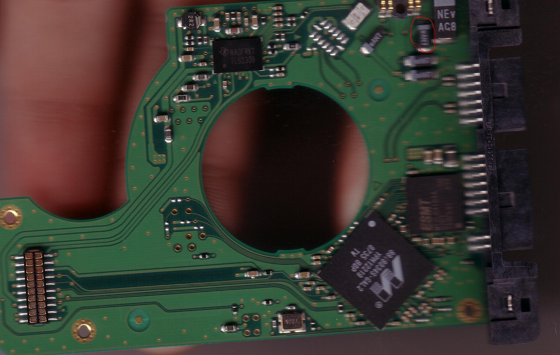

Photo of PCB, the circled chip is the chip that does not show continuity. Is this the TVS?

The photo is not very clear, but there appear to be two components with that same marking. Therefore I doubt that either is a TVS diode, at least not ones that are connected across the supply.
Does the other part measure open as well? What are those two horizontal devices directly below? AFAICT, they seem to be associated with the spindle motor circuit.

I suspect that there are actually four "wAN7" components, not two. I'm wondering whether they constitute a full wave bridge rectifier to derive emergency retract power from the motor windings after power loss.
Correct there are 4, but only 1 does not show continuity.. The one circle in red shows not continuity..

Perhaps you have a stiction issue. Maybe an unsuccessful emergency retract left the heads on the platter(s)???
