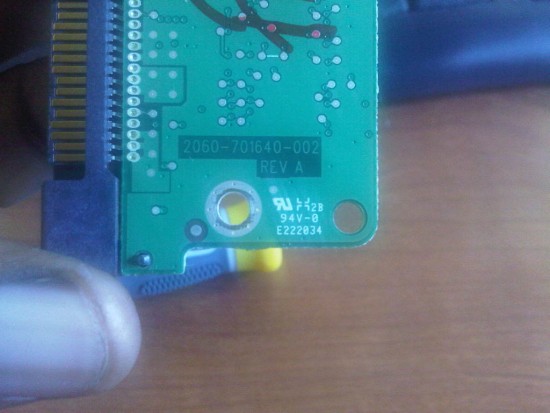

It's not a simple PCB swap.And you will not find any U12 there.
I think it's blue (-1590- or -1640-) with 2 heads, 250GB per platter side ?

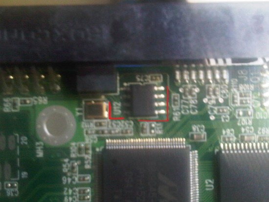

I see U12 on the PCB if thats where the ROM data is stored on this drive thats another story... Help any one... :)
ive attached to pictures for your viewing pleasure hehheheheh

You still have to change the heads. :)

Rare case, but they do exist.
You only have to find same board which has U12 also.

seems like you are correct..... but im not totally sure..... i got the exact PCB and swopped it....
powered up the HDD and got the same exact symptoms..... i did not change the firmware....
He already did a PCB swap.

This is rare. Only other ROYL disk I have seen with External ROM is 2.5" Orion family. Looks like maybe some DragFly4 also use external ROM.
