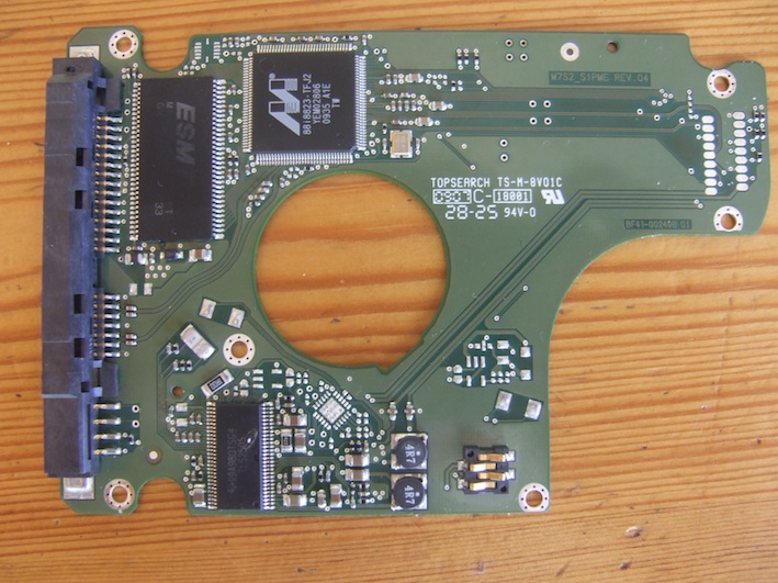

Hi Guys,
This is my first post on the forum so I shall attempt to be as clear as possible, not to ask *too* many stupid questions and thank you all in advance for any suggestions you might have!
I have a problem with a Samsung HM161HI 2.5" SATA that a friend sent to me after they accidentally knocked a glass of water onto their laptop, which promptly turned off with a pop and a smell of burning plastic!
Basically, the hard drive would no longer appear in the bios...although the laptop would still power on (when dried!) and apparently no water had got down as far the hard drive. Knowing that Samsung drives are particularly vulnerable to power surges/disturbances, I immediately took off the PCB and, sure enough, the TLS2505 chip has fried (see attached picture). I understand this TI chip to be the spindle and voice coil controller?
I have sourced a donor drive in preparation for any repairs that might be attempted and have manged to get a match that is identical and within two months of the manufacturing date of the damaged HDD.
So, my questions are as follows:
1) I presume that any kind of PCB swap (either hot or cold) is NOT going to work with this drive, as the firmware is stored within the MCU? and I would also need to transfer certain modules from the SA (an option not available to me at present)...
2) Would a spin down, hot swap and subsequent recalibration attempt (using MHDD) with a readout of the Samsung's terminal give me any useful clues?
3) Assuming that the MCU and memory were not destroyed in the same power surge that wrecked the TLS chip, would it be possible to transplant the healthy TLS2505 onto the original board, check for damaged surrounding components and see if I can get the drive working again? (I do have sufficient equipment and experience not to do one of those horrendous soldering jobs where you see about 10 pins bridged and the person is asking why it hasn't worked...)
4)What is the likelihood that the damage has spread beyond the TLS chip, deeper into the drive, potentially wrecking the preamp, etc.?
I look forward to any comments that you might have!
Many thanks,
John

 Post subject: Re: Samsung HM161HI - fried TLS chip
PostPosted: April 22nd, 2010, 7:58
Answers :
1) Yes and no - it depends on other variables at play and what happened inside tha HDA.
2) No.
3) Not many chances but this isn't gonna stopping...
4) 30-50%.

Hi BlackST,
Thanks for the prompt response and information. As they already have a full backup of their data and this is a learning curve for me - I decided to cold swap the good board to the bad body, power up and get a terminal readout. This is what I got:

Not being knowledgeable about the Samsung Terminal - can anyone tell me what 'CLA Fail'/'CLA Stuck' and the error code 'LED 1703' imply?

Implies that your drive needs pro service.
The platters are not spinning at all or no speed sense + at least 2 other serious problems.
Can't give you further details, sorry.

Maybe the heads landed on a smooth section of the platters, in which case the drive may have a stiction fault.
This thread may interest you (it has a couple of success stories):
samsung-portable-500gb-dead-t14351.html#p99445

Because the spindle motor IC has fried the head would be left somewhere near the middle of the platter. If you listen closely to the HDA you may be able to hear a pulsing sound.
As we are also talking "tribology" now an easy way to think of it is:-
Disk / head stiction is like two flat panes of glass put together. If you have ever tried it you will find that it is very hard to separate them.
The latest drives with load/unload ramps to not have a laser bump texture on the inner landing zone just like the M7 generation :O)
