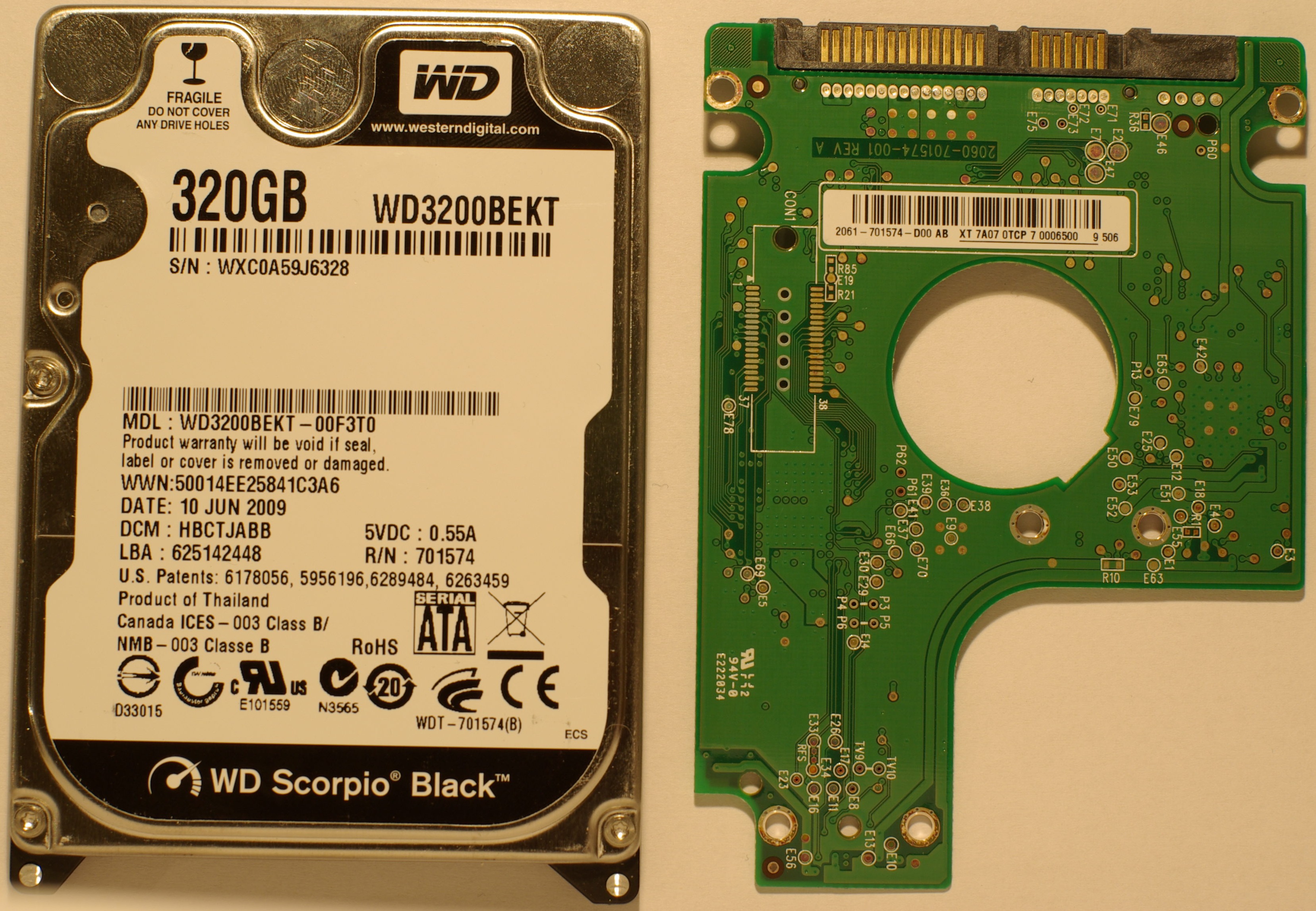

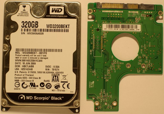

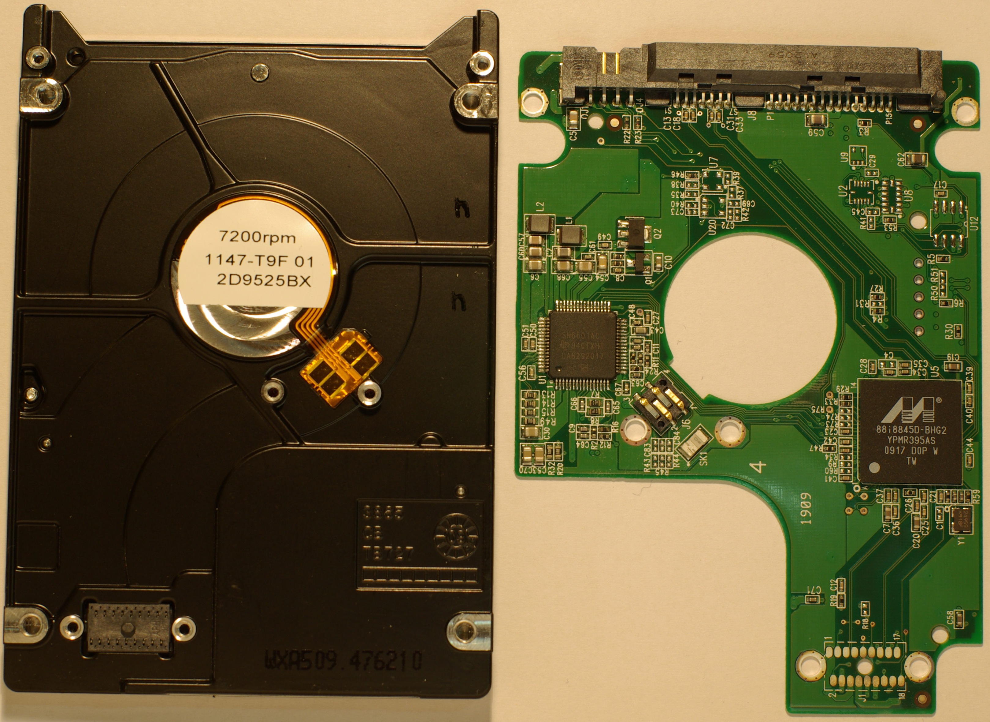

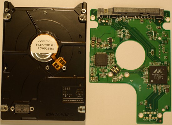

Hi guys.
First, a short recap on the chain of events.
Did a windows vista update and rebooted as prompted. Loading windows takes extremely long time.. 8-10 minutes. Thought this was due to the OS update and did not even think about a hardware error. Did another reboot.. loading windows was just as slow or even slower. Third reboot and HD not recognized by BIOS = dead HDD. Not recognized on other laptops either. No clicking sound or whatever. It just spins up and the BIOS error msg appears, then spins down.
I suspect that there might be an error on my PCB, but my untrained eyes cannot detect any burnt components... I've also read that this could be a SA error..
It is also worth mentioning that my apartment is real pain when it comes to static electricity. The discharge often happened as I sat down with my computer.. and I strongly believe that this could be the underlying reason for the breakdown. My laptop has already killed two other hard drives. I thought that there would be some sort of electrostatic shielding, and shouldn't there be? At the same time I find it strange that this occured after a windows update..
Do you guys have any idea of what is wrong? I have tried to look up identical PCBs without any luck yet..
I've attached pictures of the PCB for you to inspect, both front and back
Model info: WD3200BEKT-00F3T0
File comment: The front side of both the PCB and the hard drive case.
File comment: The back side of both the PCB and the hard drive case.
I would guess you have head damage, but at this point is just a guess. further testing is required, which will require professional equipment to do.

PCB problems are less likely than a problem with the heads.
From your information I would say weak/failing heads that have now failed. If a WD spins down after say 7-8 seconds its 9/10 a head problem.
Will need a data recovery company i'm afriad :( not one for DIY. Tools and tests are needed to confirm the fault.
Additionally the PCB has no external ROM so you would need to get the ROM over to a donor board just to test if it was the PCB.
If your looking for parts the PCB number is printed on your first picture just below the connector. I don't think this will solve the problem though.
Even if PCB is at fault, this will not work, professional tools are needed to adapt a donor PCB.
Leigh is right, a DR firm is pretty much the only option you have.

Well ,
Just for The Heck Of It Try And Clean the Contacts Where the PCB connects To the Headstack With School Eraser
