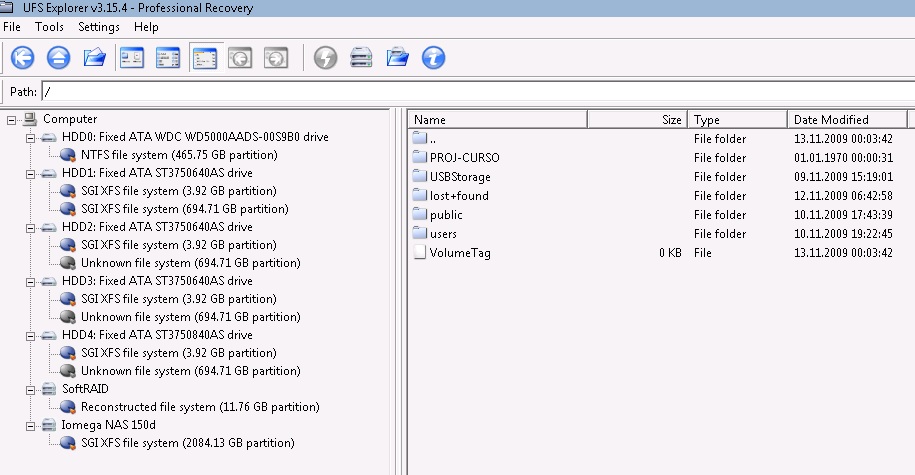

when using the UFS i can mont the raid with soft raid.
choose the explore i can see some folders the other is missing
in the NAS box i can see that the
- free space is 2TB
- Used space 2TB
it looks like dont have files there, this happen when the disk from the NAS failure and them the client change the disk and rebuild the array.
When i make a scan of this it give error about at 1hour of scanning , send the report to the (sysdev labs), but no response at this time about that error.

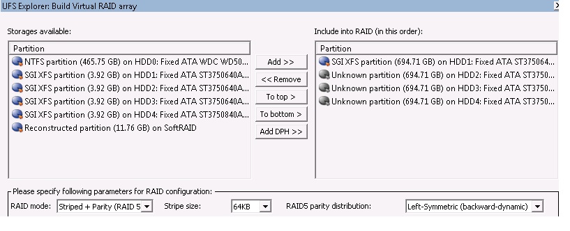

so i made an image with this settings in a 2TB file.
them try to scan the file with RAISE XFS, but the resuls where not good all the files are corrupted.
Anyone have other idyea ?

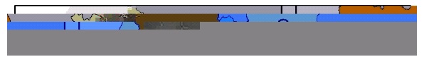

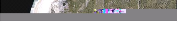

Made an image of 2TB, them scan the image but i have this in pictures.
File comment: Image File
Please let me know any comments ?

i have this exact raid system i working on now -- any hints as to the stripe size or parity, etc would be very helpful, i'm having a tough time finding them. i don't have the original unit to re-build a new one and examine the parameters so any help or hints would be helpful. so far i've been trying raid reconstructor, r-studio, and x-ways.

Neither of these softwares support XFS, which is the filesystem used by the unit.

thanks for that hddguy!! i've switched to UFS explorer with raid reconstructor now, getting somewhere, but not sure if i quite got everything right just yet. looks like 8kb stripe which starts at 8,225,281 sectors - as the first sectors are identical on all four drives (some kind of recovery partition). i was told this was a raid5 (but not sure) and also don't know the parity rotation (if it is raid5). any more help or clues if you know would be very appreciated.

just got it!! thanks so much for your help - it was key! i had to use UFS explorer, that was the only program i had to read xfs. i think the final working settings were (not sure because it's copying now and i'm not gonna stop it at this point): 4kb stripe, raid5, starting at the second partition, backwards dynamic... will report back on these settings when this finishes for future reference.
