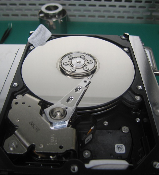

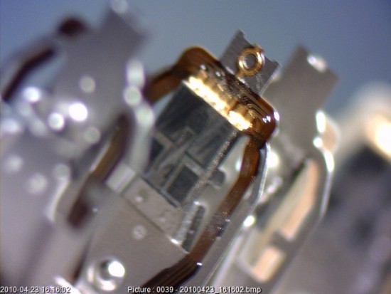

Hi to all,
Have this disk could clone it about 80%, is from a raid.

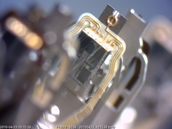

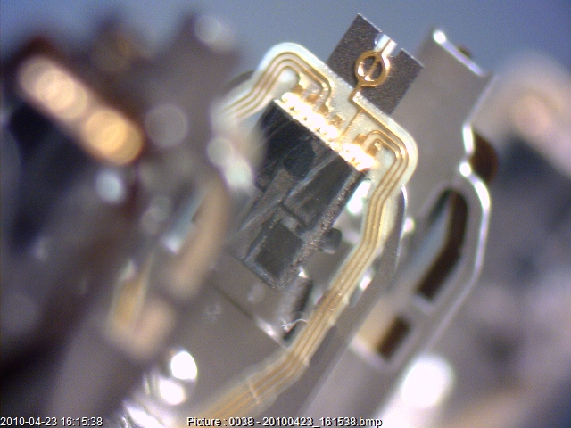

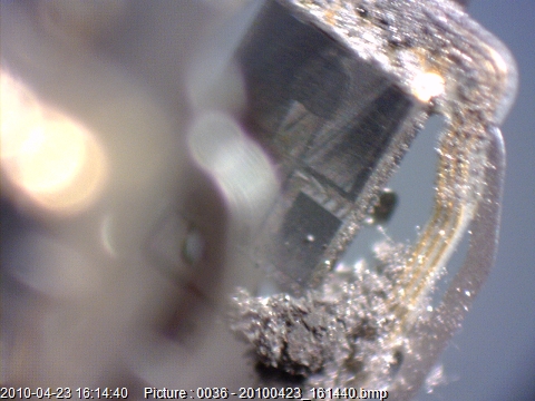

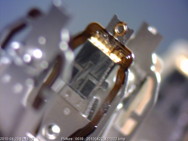

Look the heads at the microscope is like this:
I am thinking in clean the heads or change it.
Any idea ?

Might as well just try cleaning these. If the heads look like that then the likelihood of media damage is high. Putting in a new set of heads will just ruin them in short order.
 Post subject: Re: SEAGATE 7200.8
PostPosted: April 23rd, 2010, 16:47
Posts: 4854
To be honest this drive needs something more than a head replacement. But can be done.
PostPosted: April 23rd, 2010, 19:16
Posts: 1151
head look damaged already that clean may won't help and waste time on it.
data recovery service[/b]
PostPosted: April 23rd, 2010, 19:22
To me, the heads are out of order : the debris on H0 may have made a disaster on the connections when the circuit was live. It's worth a try, but you have to check thoroughly for the presence of conductive debris / dust EVERYWHERE , then check the head surface after cleaning.
I know you can do that ! ;)
