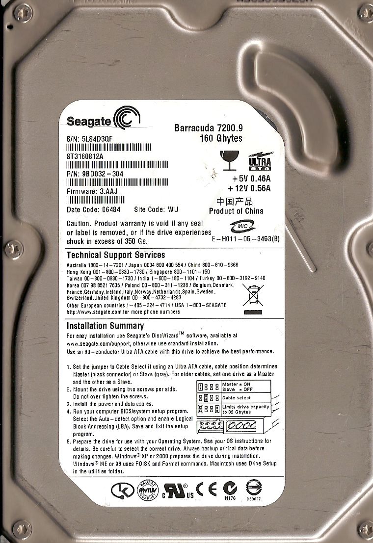

 Post subject: I need loader for ST3160812A FW3.AAJ
PostPosted: May 3rd, 2010, 20:29
Joined: March 5th, 2010, 22:59
Posts: 15
Hello!
Does anyone have the loader for this drive?
Thanks in advance for your help.
Thanks!
File comment: scan
