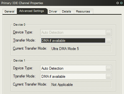

Time to update:
@BlackST thanks for the cloning suggestions, I went the other way and reinstalled the system.
As for the drive, here's the details:
After following your advice procedure, MHDD showed 0 errors in the scan test,
however it took 6h to do the ERASE.
MHDD displayed a Note saying that the ERASE would run only in PIO mode and if I wanted to go quicker, I should set DMA mode in BIOS.
Problem is, my BIOS hasn't any settings for drives, when I'm in Windows, checking Device Manager, it shows UDMA as being used as seen in the screenshot below, so I had no way to tell MHDD to run it in DMA.
My laptop is 6 years old and I flashed the BIOS to the latest available version, which is still old, and no options for drives either.
After realizing that I couldn't do nothing about it (within my knowledge) I've ran it trough the night.
Drive now is working ok and my question now is, can I trust it?
Of course that all data is currently backed up but even so, is it a normal drive again or is it prone to problems?
Thanks.
