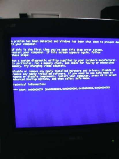

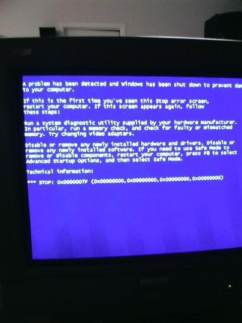

The original Dell Win XP home SP2 disc package arrived today. Brand new HD plugged in (as before). Win XP home disc in the CD rom. Power it on and I get the "hard Disk 0 not found" error. Hit F1 to try again and this time it boots from the CD....loads all the drivers....says starting windows....then I get this message - which is the exact same message I received with my Win XP Pro disc:

 Post subject: Re: Help with Western Digital Caviar 80GB IDE drive
PostPosted: May 14th, 2010, 0:43
Joined: August 31st, 2006, 17:53
Posts: 354
Location: Birmingham, Al
7F is usually a hardware error.
Since you are getting this error when booting
from cd, I would suspect this may be a memory problem.
But since you are getting "drive not found" error also,
I would try the other ide channel.
Also check your drive cables.

Update:
Had some more time to play with this tonite.
Tried the new HD in the other IDE channel --the one that recognised the CD/DVD drive-- and got a "drive 1 not found" error. Hmmm - interesting. Pulled the new HD, took a look at it, and found something. The jumper on the back was set to designate it as a "master" per the enclosed booklet that came with the drive -- except the diagram on the drive itself indicated that NO jumper is used to designate the drive as a master. So, I pulled the jumper.......re-assembled it all.....and voila - drive is found!
Now I just need to set up XP on her machine. I may use the copy of XP Pro SP3 that came with my Vostro 220's instead of her copy of XP home SP2. Heard that Microsoft will only be updating XP Pro and has dropped support for XP home already?
