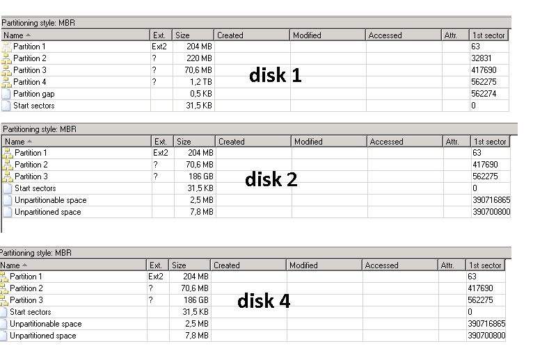

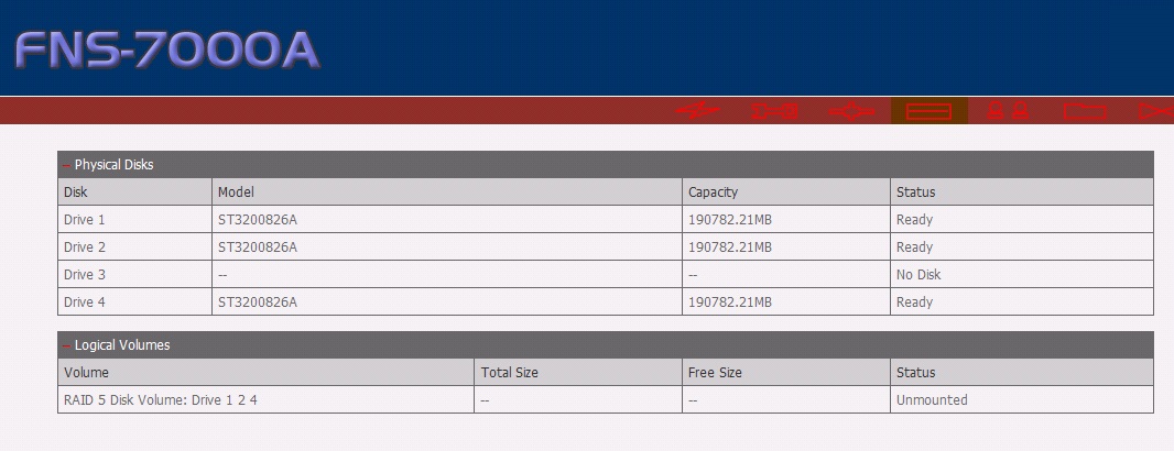

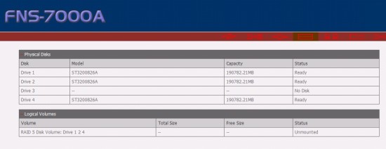

Hi to all,
I am working on this NAS with 4 disk.
Disk 1 - ok
Disk 2 - ok
Disk 3 - long time no working
Disk 4 - ok
in the NAS it appear not mounted, so it can not give any volume.
The configuration have 3 partitions
1 - ext2/3
2 -
3 -
i try with winhex but could not determinate anything incluing the 1 partition Ext2/3
Anyone have worked with this NAS ?
Try to mount the disk in a Fedora Live USB , i can see that there is an array but nothing more.
Also i used the NAS with new disk and make a configuration clean and working, try to run it on the Fedora but could not acess the files ! strange..
Can this NAS be with some configuration locked from the manufacturing ?
Wating for some opinion on this, will be great,
ZeBong

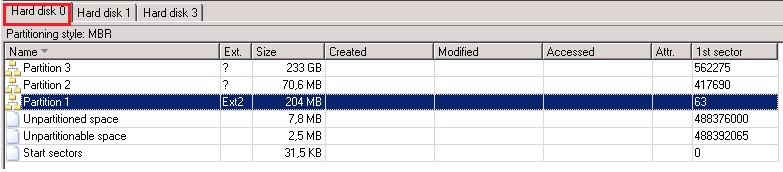

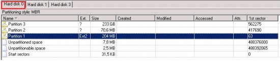

 Post subject: Re: L e v e l O n e - NAS - 7 0 0 0 A
PostPosted: May 13th, 2010, 17:10
Posts: 1421
Location: EUROPE
Thanks CK,
I try also UFS, and the NAS come from factory without no disk inside ,
So i put new disk made a raid 5 copy some pictures to there
them try to rebuild with UFS and nothing also happen
Even the first partition Ext2, i can not see anything with UFS.
It looks simple, just unmounted volume.
No luck at the moment.
ZeBong
" Россия еще раз"

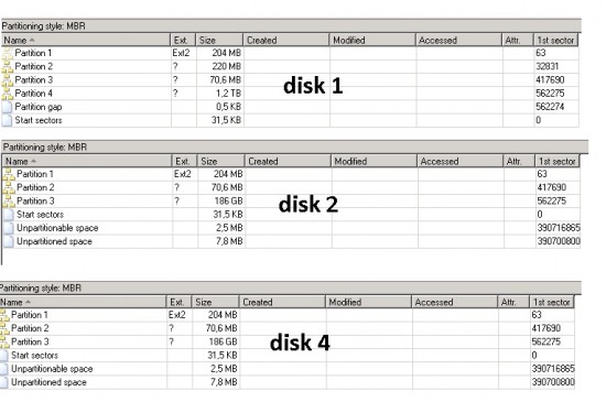

PostPosted: May 13th, 2010, 17:16
Posts: 3235
Location: USA
what are the partition type codes from the MBR? also does every drive show the partitions, or just one or two?
PostPosted: May 13th, 2010, 18:05
Posts: 1421
Location: EUROPE
The drives show all the partition,
but the first one it show one more partition them it should be.
Also i notice that the volume of the 4 Partition is not right, because it says 1.2TB
And the original volume was 558Mb ( 4 x 200Gb Raid 5)
ZeBong
" Россия еще раз"

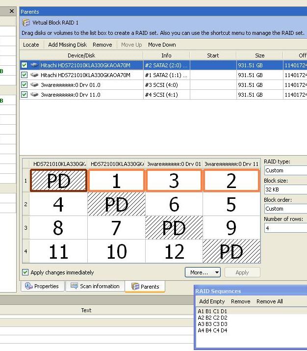

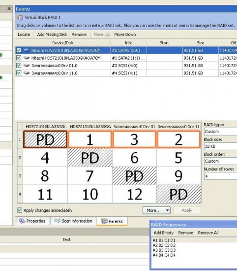

PostPosted: May 20th, 2010, 4:21
Posts: 1093
Location: Angel Data Recovery
Raid 5 configuration of this NAS can be uniq . WinHex and UFSExplorer know only typical configurations like backward Sync/Async parity and forward Sync/Async parity.
You need R-Studio and build custom matrix of your RAID configuration
For example for NAS4300 we meet something like this :
If you still need, we can help you on distance by TeamViewer.
Angel Data Recovery
