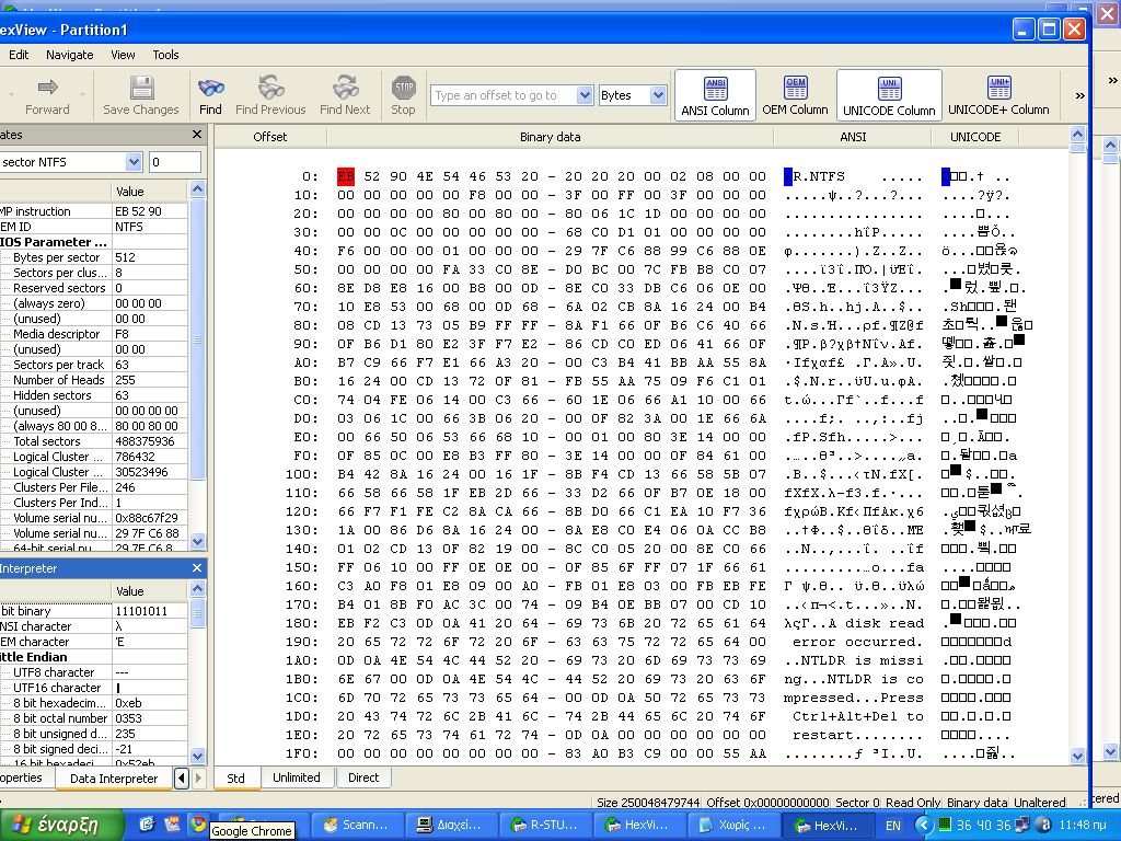

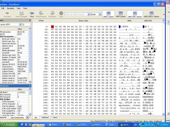

well i uploaded the file.
i had imaged the drive with FTK Imager *.dd
and i am using R-Studio to explore it.
i get data but unfortunately i am only getting raw files

That's the boot sector at LBA 63 (= logical sector 0 of the volume). AFAICT, it looks like a normal NTFS boot sector.
See http://mirror.href.com/thestarman/asm/mbr/NTFSBR.htm
The partition table is at LBA 0. Offsets 1BE - 1CD will contain the partition data.
I believe the table should look something like the following:
0x01be   80 01 01 00 07 fe ff ff 3f 00 00 00 81 06 1c 1d
The leading 80 indicates that the partition is active. A 00 indicates that it is not bootable.
