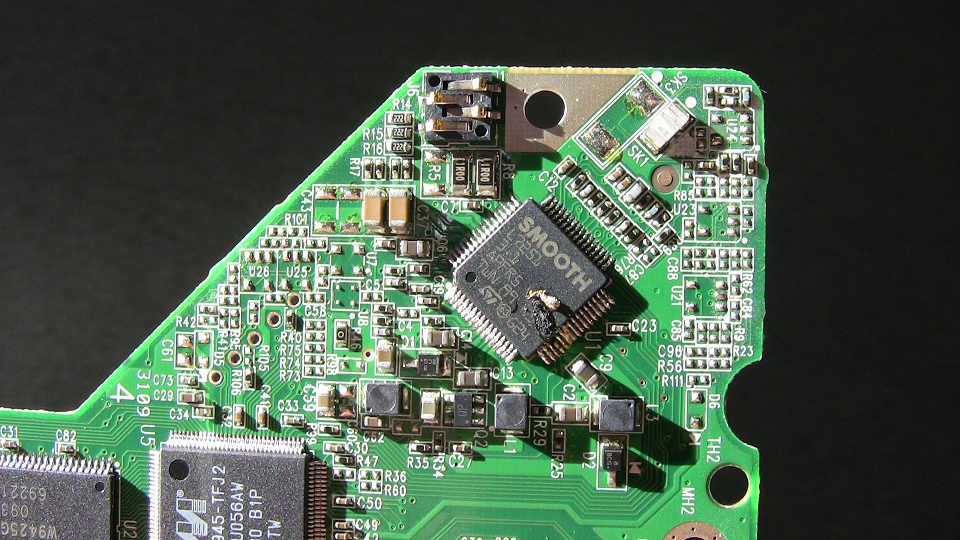

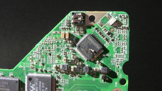

File comment: Closer to the burned chip

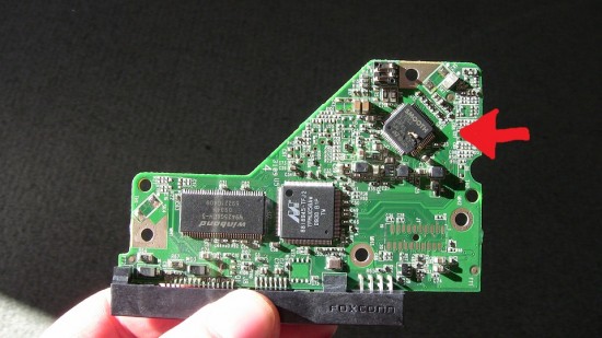

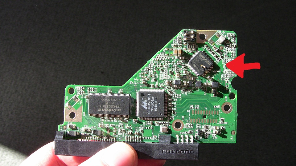

File comment: The WD10EADS

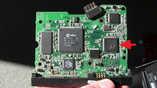

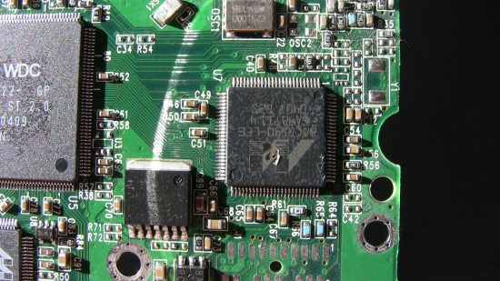

File comment: That's the WD2000

Also a question on a picture of ur 1TB PCB i see that u are missing ur U12 ( eeprom ) Did u already take it out ?

well , i dont really know why, but the picture of ur 1TB WD is missing eeprom... Its strange unless that WD model can store adaptives at eeprom OR embeded. If its embeded u going to need help from a pro.

This 1Tb doesn't have an external ROM, it's embedded in the MCU. The pads for the ROM are there in case you need to put an external ROM there to fix up a buggered/misprogrammed internal ROM which is preventing the PCB starting.

:arrow: Alexii - look at the picture ...

The ROM in this HDD is stored in the Marvell CPU 88i8945-TFJ2
(if is an external ROM - is a different processor 88i9045-TFJ2)
ROM can be:
-readed from the original processor...
-the processor can be transferred from patient PCB to donor PCB...
-Base part of ROM can be readed from SA (if original CPU is damaged), unfortunately (probably) modules 102-107 are NOT_INIT in this HDD...

You can get an idea if the MCU or other chips are damaged by measuring the load resistance at each of the onboard regulators.
For the WD10EADS board, measure the resistances between ground and each side of the inductors (L1, L2, L3) below the SMOOTH chip. Also test diodes D2 and D1.
You can also check the outputs of the regulator (TLE4417, IRU1239SC) for the WD2000 by referring to the datasheet of a compatible (?) IC.
STMicroelectronics ST3L01K7R IC REG TRIPLE 2.6/3.3/8V 7SPAK:
http://www.st.com/stonline/books/pdf/docs/8618.pdf
http://catalog.digikey.com/scripts/part ... -4313-1-ND
You may not be able to repair anything, but the above tests will help you assess the damage.

The photo that shows damage to the larger Marvell chip suggests catastrophic (i.e. widespread) damage, and my guess is the preamp is probably dead in that one.
Professional assistance is required for both of these.
