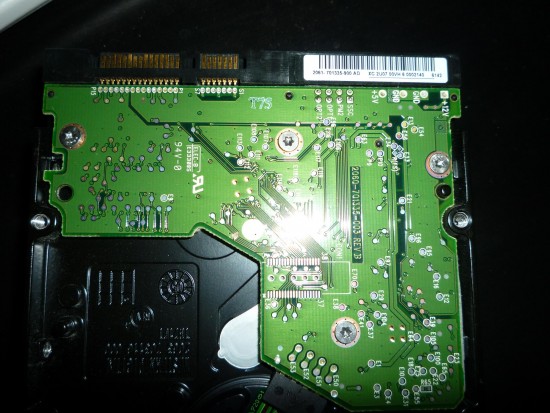

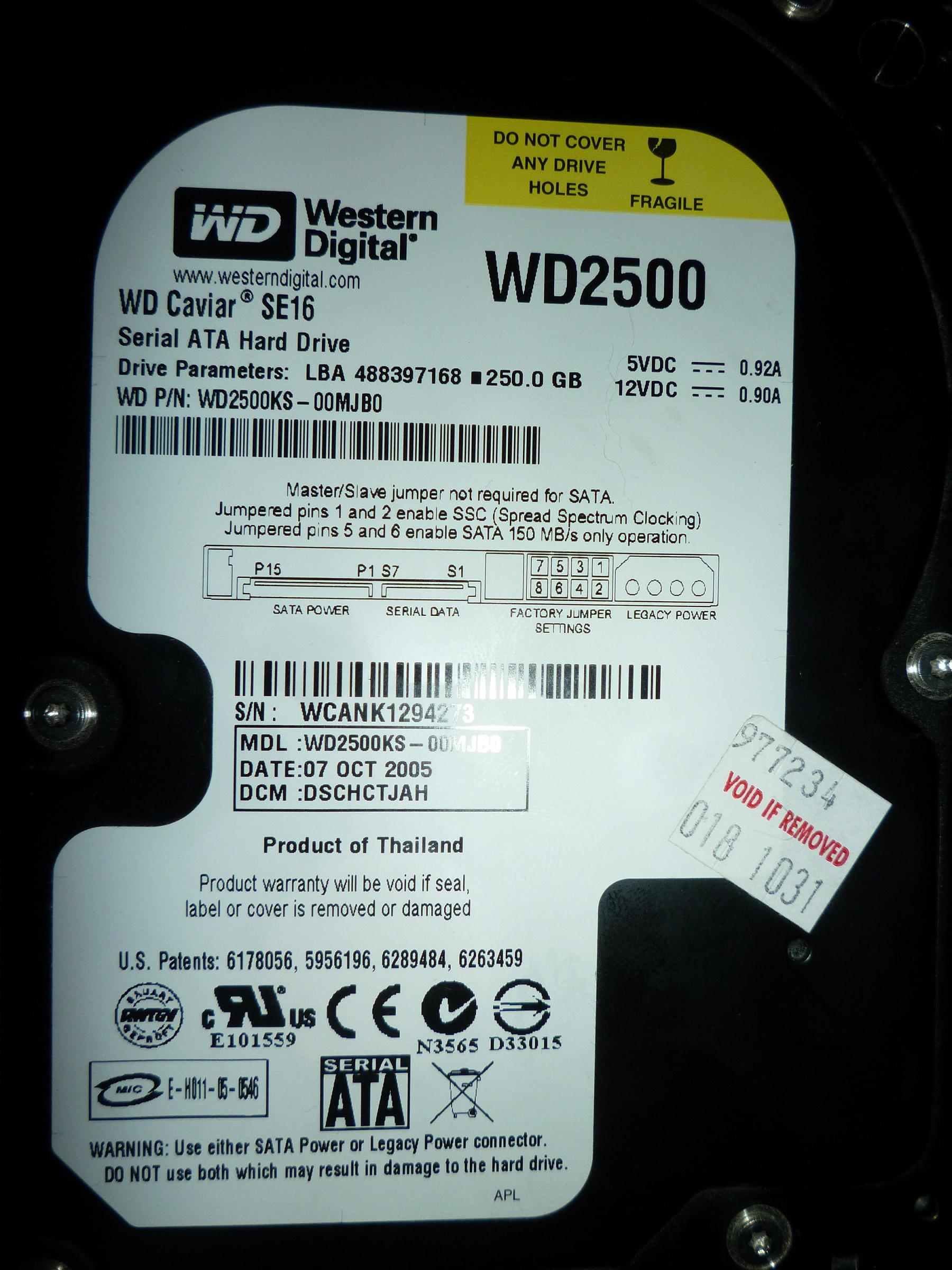

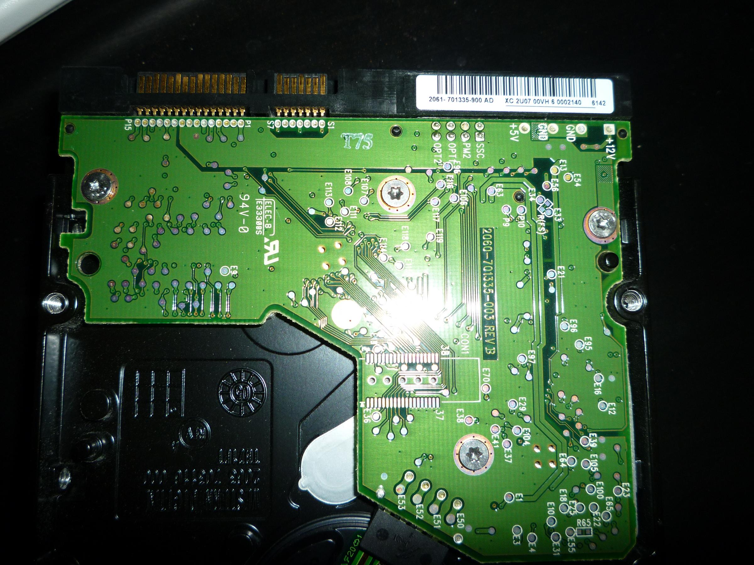

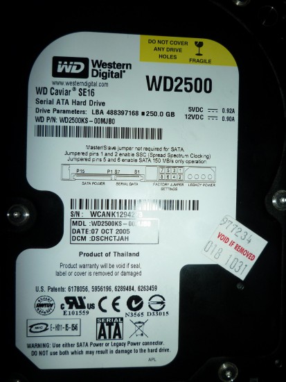

I will attach a pic of the front and back of the HD, I noticed last night that on alot of the PCB contacts there is heat discoloration making me lean towards thinking the board fried.

You have a scratch on a platter or one of the heads dead or both.
Sorry, but you will need a pro help.

how do you know this? im not questioning your knowledge level cause its obvious you know more than I do. Im just curious what out of the info pointed to your conclusion.

so it couldnt be a board issue huh? bummer ... was hopin it was something easy like the board just being fried out. well I guess I will just have to research prices to recover data off the drive.
