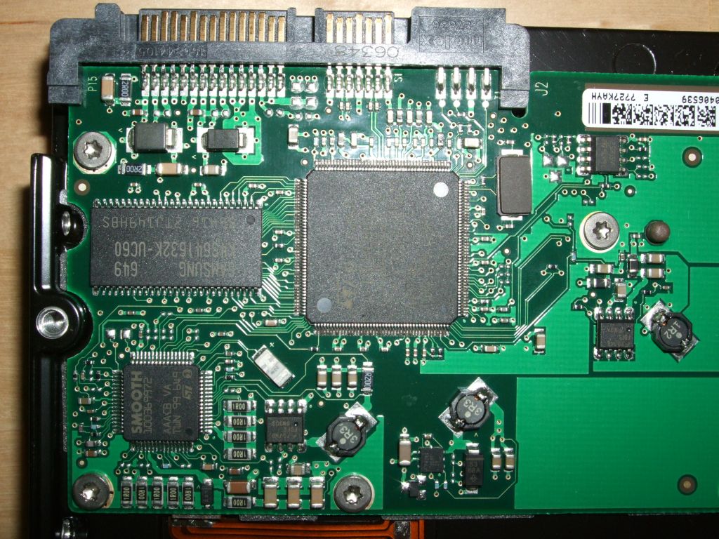

Fried the drive......again.
Last time I just popped off the TVS diode and life was good for data recovery.
Anyone know where it is on this one?
 Post subject: Re: Where is the diode?
PostPosted: June 8th, 2010, 13:28
Posts: 1721
The two right under you power connector. Test them

Can you please clarify "test them".
I have a Fluke Digital Multimeter (auto range); should I just set it to resistance mode and check for a dead short? Or use the continuity checker that beeps of shorted?

You don't check a diode with Ohm Meter, check it with a Diode tester option.
