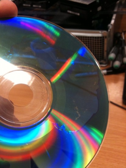

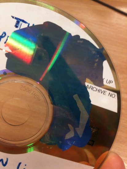

 Post subject: CD Recovery top part damaged
PostPosted: June 7th, 2010, 8:14
Posts: 248
Any ideas? , new top cover? dont even know if that works
underside is fine
nothing sees it
thanks
andy
File comment: Top Part Peeled

Just a small "point" , but the data is actually stored on the interface between the silver and the Dye, the plastic disk ("underside") is just a carrier for the silver area.

very easy to recovery :)
the data will still be there its between the layers

how exactly?

No chance. Upper layer is reflective
