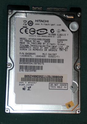

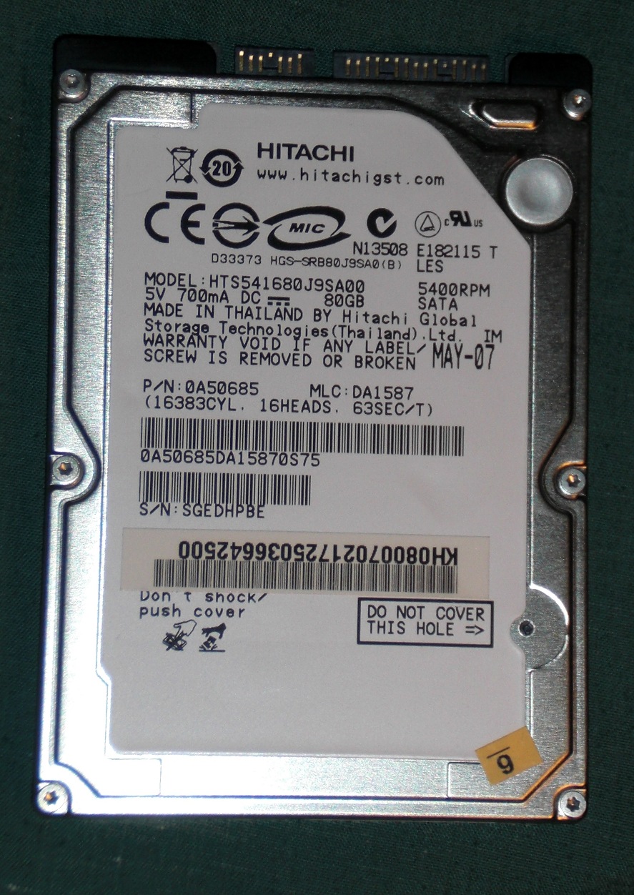

Hello, I'm looking for a doner drive for an 80GB SATA 2.5" Hitachi HTS541680J9SA00. I was told that not only do I need to get the model number right but also the PCB number burned in on the opposite side of the hard drive needs to match. I'm looking on Ebay and I found one that provides pictures and matches kind of expensive though. Is this all that needs to match? What if the manufacture date is different by 6 months? Does anyone know where I can go to understand the acronyms and info put on the front label. :(
I've spent hours watching videos from myharddrivedied.com and reading information on the internet. I'm quite a noob in this area. I don't have a ton of money to spend on this and really want to learn how to do it myself. Does anyone have any advice for me in general?
This hard drive isn't recognized by the BIOS and makes a clicking sound when given power. Notebook that it was in was dropped only 6 to 8 centimeters. I have not removed the case as I have heard about hard drive degradation. Does anyone know typically how many platters are on 80GB Sata drives from Hitachi? What would be the easiest way to go about fixing this if I have a doner drive. Thanks for any information you can provide me with.
 Post subject: Re: HTS541680J9SA00 Hitachi Donor Drive + Advice
PostPosted: July 6th, 2008, 19:31
Posts: 1079
Location: canada
ok you must match up the following the manufacture date i would try and match up to the close as you can.
its impossible to match the right month of drive sometimes
allso try and match up where it was made in thailand
the other you got to match up are
1)firmware code mlc number DA1587 (must match)
2)part number p/n
3)the underside of the logic board white label pcb rev has to match.
as the drive has been dropped the head is possible damaged now.
or just lost its service track data.

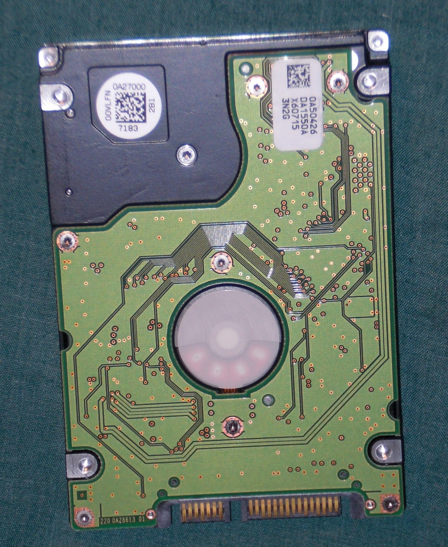

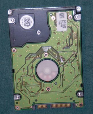

Hey Craig! Thanks for the help! I've got some money to spend. I mean, I don't know if I have the money to buy a Platter extractor that costs 500 dollars.
Craig, the PCB rev is which white sticker on the back? The rectangle one right? I need to match up every single number on that sticker? Which part is the PCB number and which number is the rev?
I was told that the PCB number is the small numbers on the board (not on the sticker)

You are well advised to contact Hitachi. I suspect your actual PCB is fine, so an exact firmware match may not be required if you simply transplant it to the donor drive chassis if the heads/preamp assembly is the same. Call them up!
The PCB sticker is unique, hence you see the "matrix" barcode on it, but the first two strings from it would denote the PCB revision. You'll find that having a matching MLC will usually mean you got this PCB matched as well, if the drive model and p/n are identical. Note that Hitachi may have more than one identical part number to this drive. They will look up additional part numbers for you.
In practice, if you get the drive from within a couple of months of this one, it will have a matching PCB rev most likely anyway.
