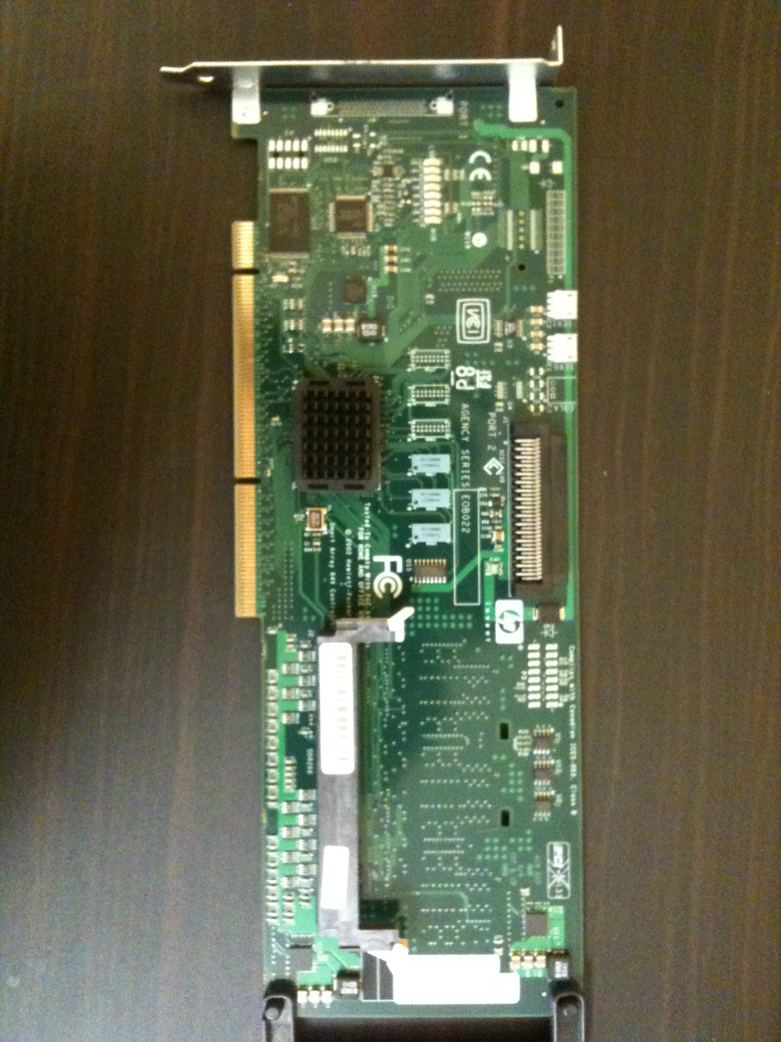

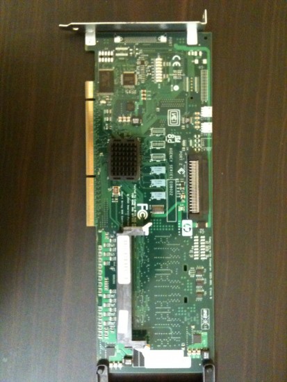

Using hardware raid card, HP Smartarray 64X controller. (attached picture). It is a SCSI RAID card.
I will check with Winhex. Do you have any indication on what to look for when I open in Winhex?
Thanks for your help

The SCSI card is HP SmartArray 641 Controller. It is 64bit/100Mhz PCI-X type card. Does anyone know default block size and block order for this card?

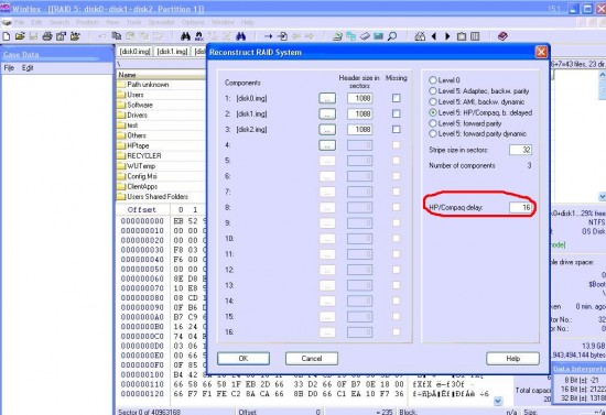

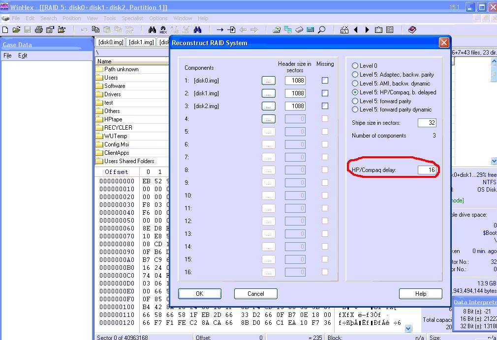

Finally solved and recovered data.
My thanks to all those who helped in this forum. My special thanks to microsoftengineer and DR-Kiev who took time to troubleshoot it remotely.
The initial problem was due to R-Studio image. The image was compressed and that created some problems in identifying parts of the image using winhex. DR-Kiev did a wonderful job. He immediately spotted issues and we did a re-image using winhex. Then opened the image using winhex and found out block size, order and delays (this where DR-Kiev experience comes into play, he is really a RAID expert) and used it to build RAID volume on winhex
The server was using HP smartarray 641 and the settings as found out are
Block Size: 32Kb
Block Order: 0,1,2
Delays: 16
Start of sector: 1088
Putting these values RAID array was build in winhex and then cloned to a physical hard disk and read out using R-studio from the physical disk.
All looked very easy when doing with DR-Kiev, but it is his experience that made it possible.
Thanks again for DR-Kiev great help and critical time.
Cheers
-Jag

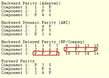

What does it mean by "Delays" in this context ?
Block size, Block Order and Starting sector are self explanitory
(athough may need to experiment to confirm the correct settings)
For this 3 drive Raid-5 system, would expect the data and parity blocks to be in the order
B0 B1 P01
B2 P23 B3
P34 B4 B5
B6 B7 P67
etc
or similar
all in block sized chunks
sounds like something to do with overriding the 'delay' / position of the parity block
Update: Presumably controls the placing of the parity block and what drive it is on and how it moves on subsequent stripes, especially for RAID5 units with more physical drives where there is more possibilitys of where to put it
Start sector of 1088 also sounds strange
Thanks for any enlightenment
 Post subject: Re: RAID recovery - can see folder structure but files corrupted
PostPosted: June 16th, 2010, 6:12
Posts: 1093
Location: Angel Data Recovery
jag17,
Thanks for the nice feedback :wink:
xsoliman,
Do you ever work with HP servers?
Angel Data Recovery
