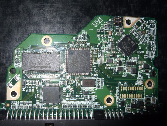

Hello.
My WD1600AAJB suddenly fail.
Disk spin up, but not detecting by BIOS. No noise or visual damage on PCB.
I bought a new similar disk and swap PCB. No luck.
I looking for the U12 chip, but can not see it.
Patient disk:
WD1600AAJB-00J3A0
Date: 02 apr 2009
DCM: DGRNHTJAGN
PCB: 2060-701596-001 REV P1
Donner disk:
WD1600AAJB-56R1A0
Date: 16 feb 2010
DCM: HHRNNT2AHN
On Ebay it is an other PCB for sale, is this a better choise?
WD1600AAJB-00J3A0
DATE: 06 FEB 2009
DCM: HGRNHTJAHN
2060-701596-001 rev P1 on the PCB
So, what to do?
Picture on patient PCB.

This board does not have an external flash chip. It has a masked ROM within the CPU- the large chip on the board marked with an M. If the PCB is the problem- which it may not be- you will need a professional to copy the contents of the ROM from the patient to the donor. Although you would- like everyone else on this forum -like to do this yourself, I'm afraid unless you invest substantial money in the necessary professional tools this is not possible. Moreover, the PCB is not necessarily the cause of the problem so you'd still need to find a professional DR service if your data is critical.

There are many reasons other than PCB failure that a drive will not show in BIOS. Among them are: head(s) failure, firmware damage, platter surface damage, or any combination of these. In fact, PCB failure is usually the cause - in our experience- about 10% of the time.

since there is no ROM, neither place for it on that pcb, the drive will need professional attention.
it is not about swapping ICs. If u would like to see your data again I suggest stopping DIY attempts before it will be late.

It's probably a firmware problem - e.g. module 11 is corrupted. If so, there is nothing you can do yourself.
