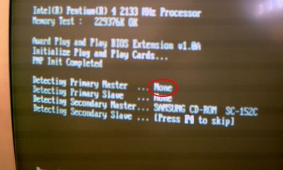

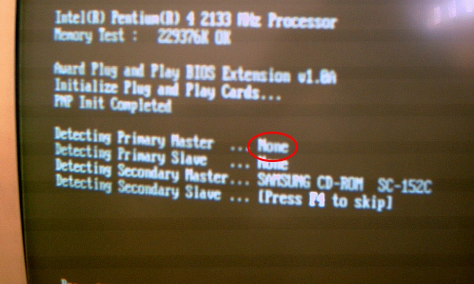

I have 3 units of Seagate 80GB desktop 3.5" IDE hard drives that are not able to be detected by BIOS when i boot up my computer and also having the same problem when i tried another computer. MHDD also not able to detect the hard drives. The hard disks spins all along and does not spin-down or make any clicking sound. See attached screen message.
Seagate Barracuda 7200rpm ST3802110A
Appreciate if anyone can help! Thanks

they probably suffer of some PCB problem or the bearing is seized or heads are stuck on the platters... First one has more probability.

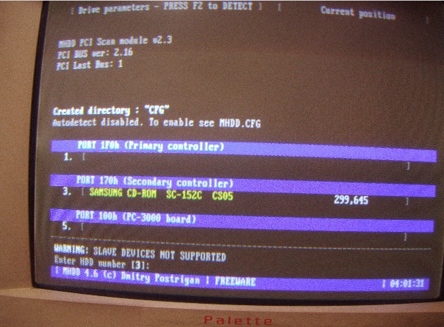

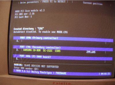

MHDD cannot detect the hard drives
 Post subject: Re: BIOS cannot detect HDD
PostPosted: February 9th, 2008, 12:36
Joined: October 19th, 2006, 11:56
Posts: 217
OK. connect the drive as primary master (Don't connect power supply yet). Now run mhdd and keep your eye in the top (where are the signal indication..DRDY..ERR...T0NF and BSY etc) now, as you connect the power, note the signals out there and keep them watching for one minute and give me the details here...then we will workout furthur.....
Hello HardDiskBug,
Please correct me if the steps are correct or not.
Tested on the three undetected by BIOS drives one at a time.
1. Connected the drives as primary master without attaching the power connector to the drives and run MHDD
2. Port 1F0h shows no detection and i pressed HDD number "1"
3. all the three drives "WRFT" signal indicator shows a quick blink
4. When i attached the power connector to the drives ,
*1st drive - only "BUSY" indicator signal on
*2nd drives - only "BUSY" and "UNCR" indicator signal on
*3rd drives - only "BUSY", "AMMF" and "ABRT" indicator signal on
5. after one minute, signal indicators remains as it is for the three drives
Thanks for your time and help!

Well, as all the drives remained BUSY, it means some problems are in drive itself. Now, the next thing you should do is to check the drive in terminal and put here the terminal log...
