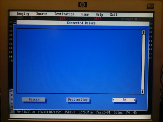

Hi
I have a hitachi 80GB IDE drive
IC25N080ATMR04-0
P/N: 13G1264
MLC: H69519
PCB: 14R9060
J41063D
On power on it gives some clicking sounds and then some strange like screeching noise, you can view here
http://www.youtube.com/watch?v=gBFrPqtLDi8

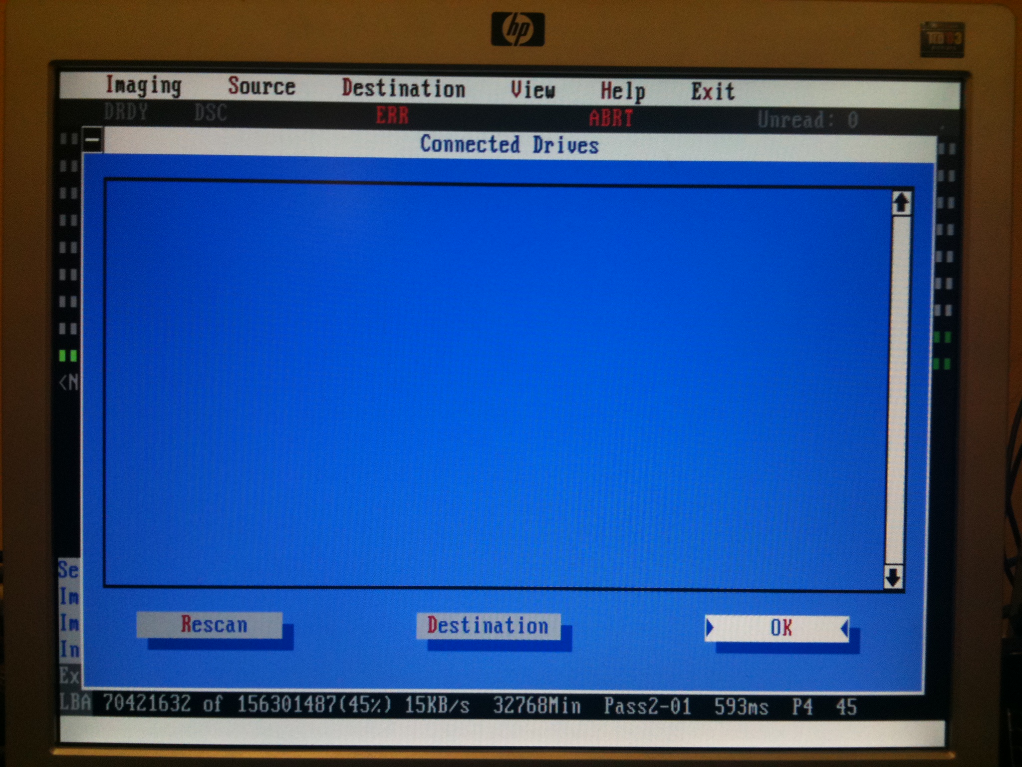

DDI does not detect. Attached screenshot of DDI status on this hard disk
Is this bad head ? what is the best way to test and recover data?
Thanks for your help
Cheers
-Jag

Bad head(s) / possible media damage.
Best way to recover depends upon specifics, which you have not discovered.
