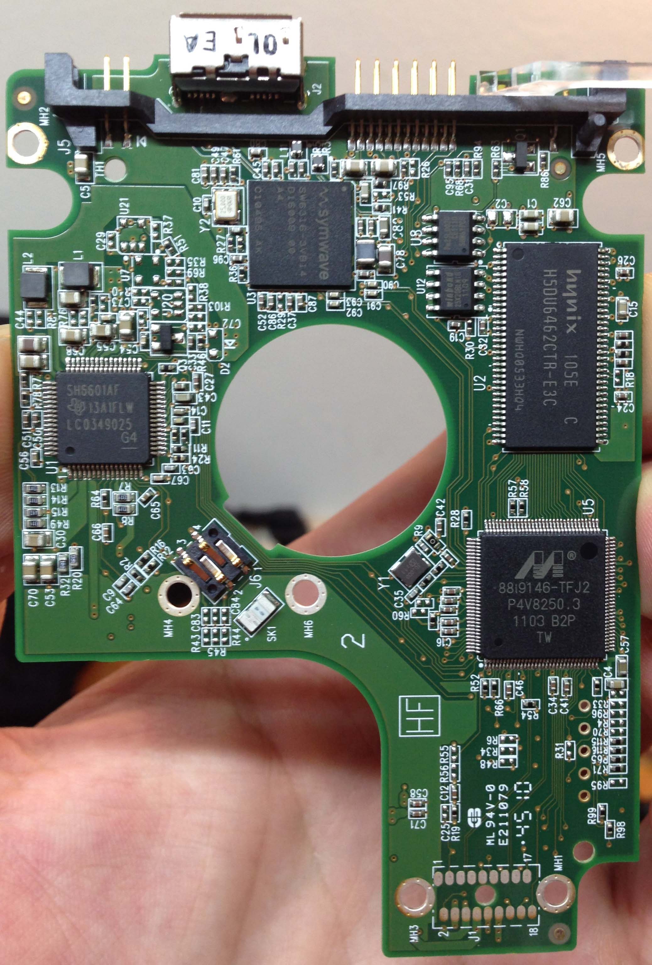

Hi.
Does anyone know what are the sata connectors and power of this card?
Thanks!
 Post subject: Re: WD5000BMVV connector
PostPosted: September 9th, 2014, 11:39
Joined: September 9th, 2014, 11:28
Posts: 8
Location: Italia

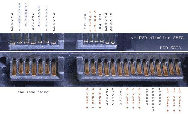

I found this but it is without any description.
PostPosted: September 9th, 2014, 17:56
Posts: 14945
Those appear to be the SATA Tx/Rx differential pairs, plus the +5V and Ground pins. The photo is demonstrating how to convert the drive from USB to SATA.

Yes but I would like to know which is the "transmit +", "transmit -", "receive -", "receive +" and ground?
Thanks.
PostPosted: September 10th, 2014, 3:50
Posts: 815
Location: World
Thanks!
put here pics from both PCB sides, please

Does this help?
http://ep.yimg.com/ca/I/yhst-1443758497 ... 69_3423582
http://ep.yimg.com/ay/yhst-144375849714 ... v-p1-5.gif
Same MCU, different boards. Follow the Tx/Rx pins from the SATA connector to the MCU.

Hi mircot80,
Put here pics from your PCB?
fzabkar can help you to find points

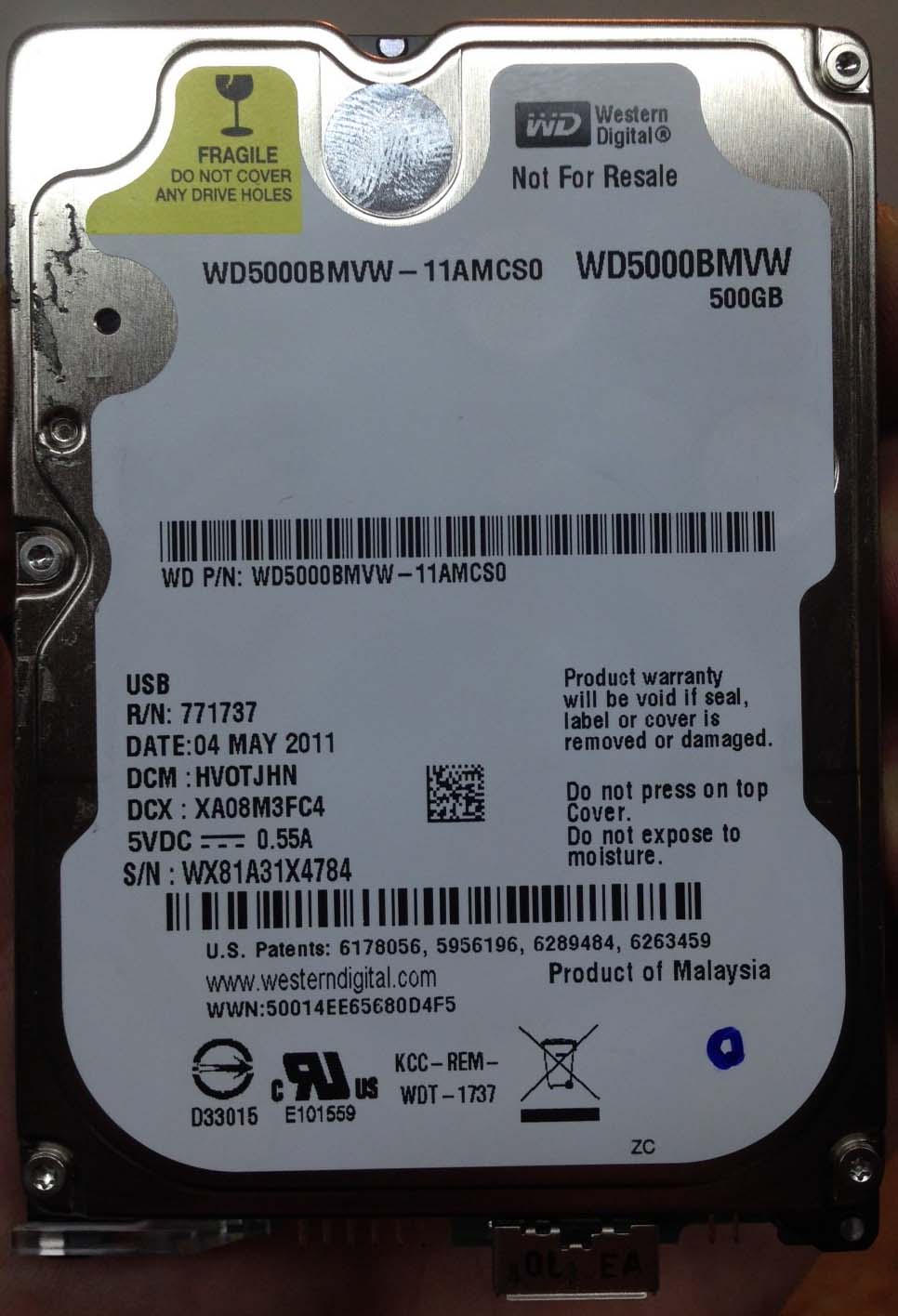

I have the same WD5000BMVW-11AMCS0 with real time encryption, and I changed my failed pcb a few years ago (need swap U8 and U12). I done sata connection at that time (for nothing), and I can certainly find the right pinout if you want.
PostPosted: September 10th, 2014, 4:56
Posts: 8
Location: Italia
how can I know if there is real time encryption?
Yes, what are the right pin out?
Thanks.
