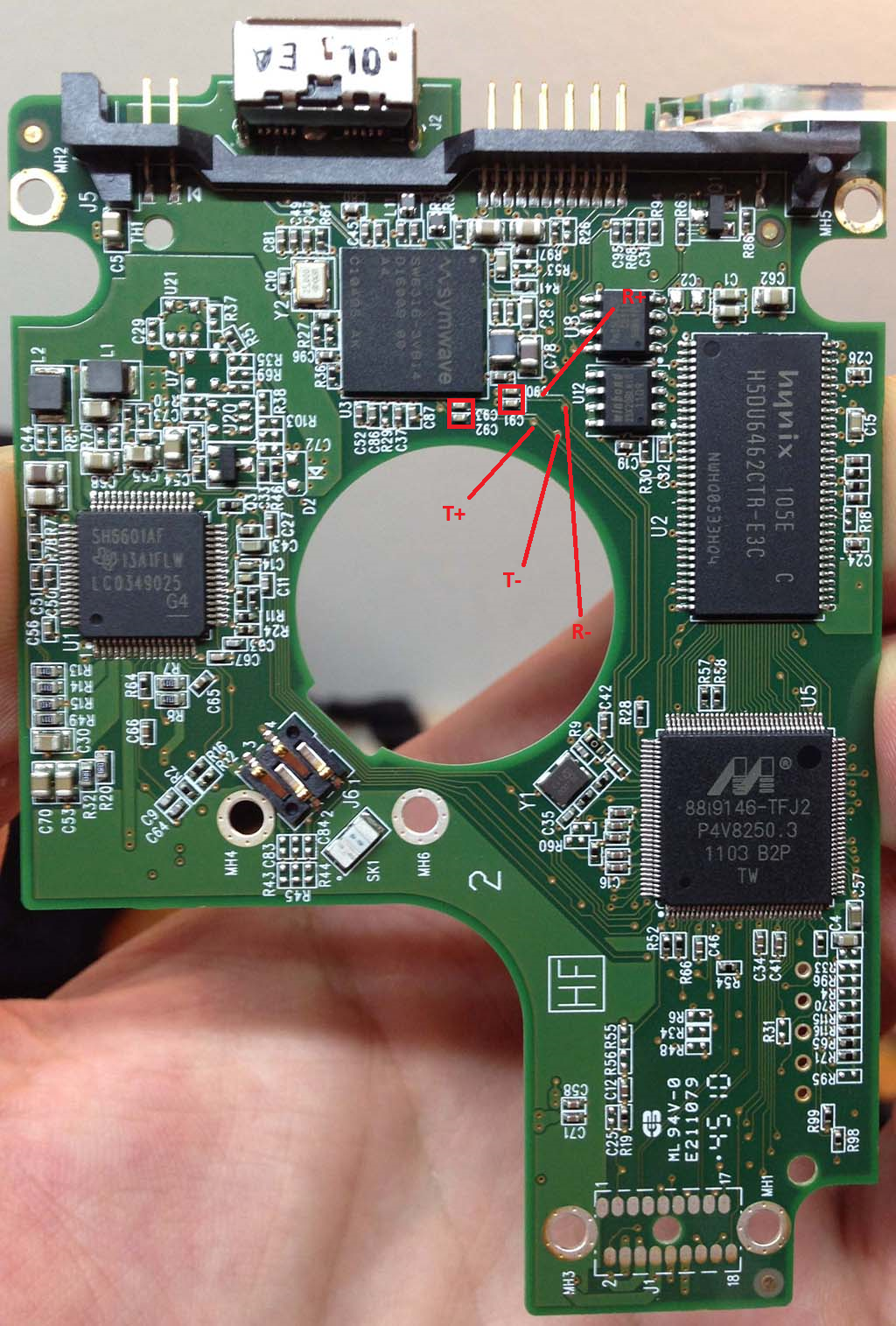

mircot80 wrote:
how can I know if there is real time encryption?
I think with same part number, your drive have also real time encryption. When I connected my drive with sata connection, I couldn't see any files, and it was ok with new pcb (usb 3.0 connection). No doubt on encryption with this drive.
 Post subject: Re: WD5000BMVV connector
PostPosted: September 10th, 2014, 5:27
Posts: 14945
Here are the Tx/Rx pins.

To do a SATA conversion you would need to remove C90, C91, C92 & C93
Loki

mircot80 wrote:
I'll try and let you know.
Thanks.
I was also going to ask what issue the had was having as it was not said in the original post.
If the drive is from a WD Passport Essential then doing this sata hack this will not give you access to the data as the data will still be encrypted.
Loki

My WD Passport works fine, and I have datas on it. But if I swap back my old "sata" pcb (eeproms have same content), I can't read encrypted datas. However I can format the drive, put new files, and use it as a normal sata drive.
For data recovery, I agree it's a wast of time.

I bought the pcb, I have moved the eprom and I restored the data with GetDataBack.
Everything ok, thank you.

Just remember that these drives are hardware encrypted and when you solder in a SATA port you are before the encryption chip. So you might have to set up a decryptor board from a My Book to translate the data. Unless you have PC-3000 (thanks Ace Labs!)
