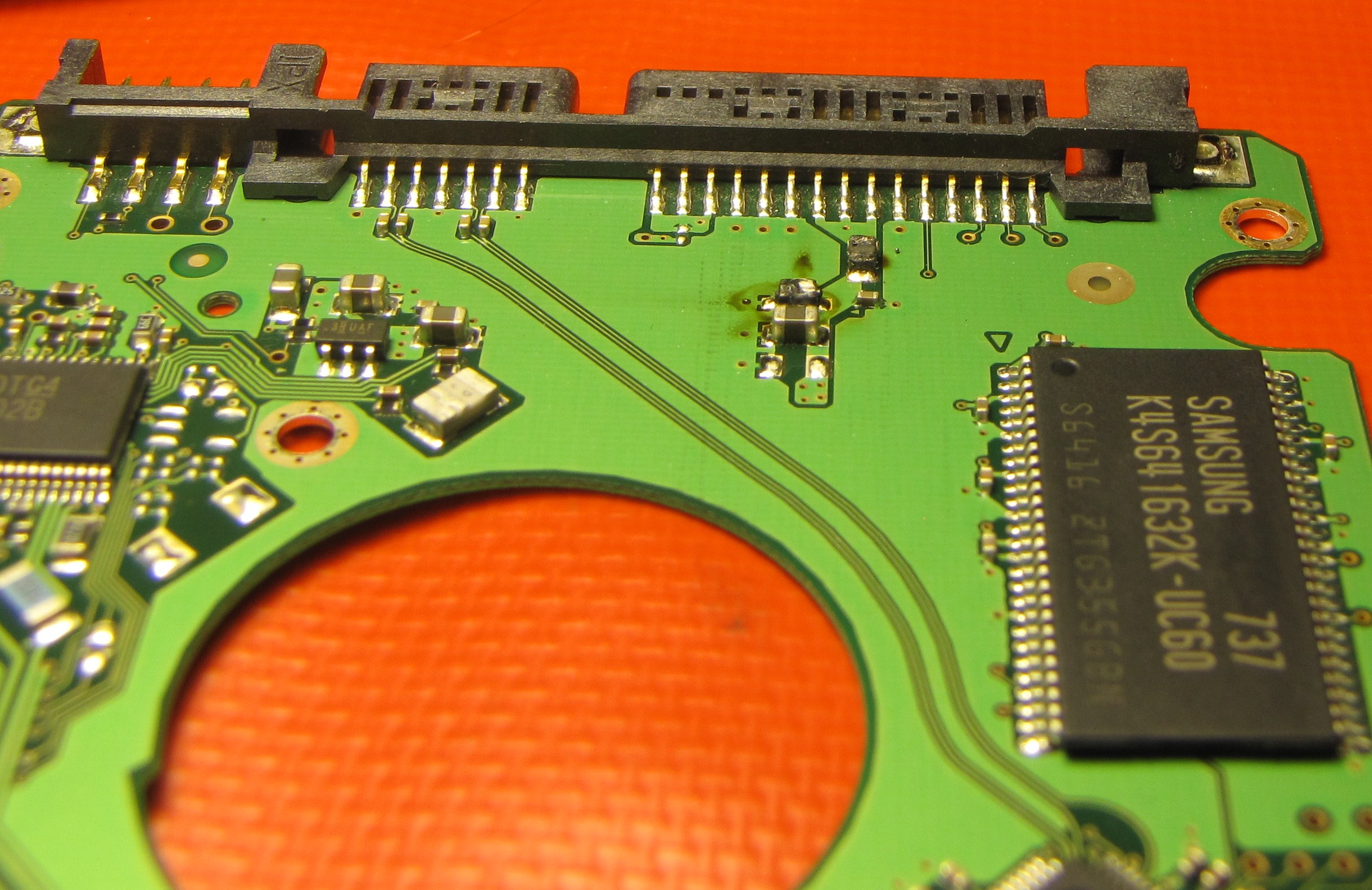

Greetings All,
I have a PCB with some burned spots on a Samsung HM320JI F/W S2200_00. Can anyone tell me if there is adaptive info stored in the burned chips? (PC3K doesn't have any diagrams for this particular model, so I'm not sure what they are. )
Can I replace them from another HM320JI with a different F/W (S2200_01 or S2200_07)?
TIA

These are fuses/protection resistors. There is some sort of shortcircuit on the pcb.

Thanks, Dobre. The laptop was dropped, so that probably explains the shortcircuit.

I think the problem is elsewhere.
Anyway, if you are lucky enough you can replace just the PCB , if it doesn't come ready or clicks or have strange diagnostic errors, there is incompatibility.
About this :
the answer is NO (as not guaranteed to work).
ROTFLMAO.
The vertically mounted part is either a fuse or an inductor, or a low ohm resistor.
The horizontally mounted part is probably a 5V TVS diode.
One part will be shorted, the other open. I'll leave you to determine which is which.

I prefer Hilti hammers and percussion drills :D
In any case part of FW is in the embedded rom, part on platters.... and everything must match.
