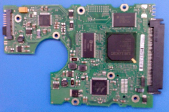

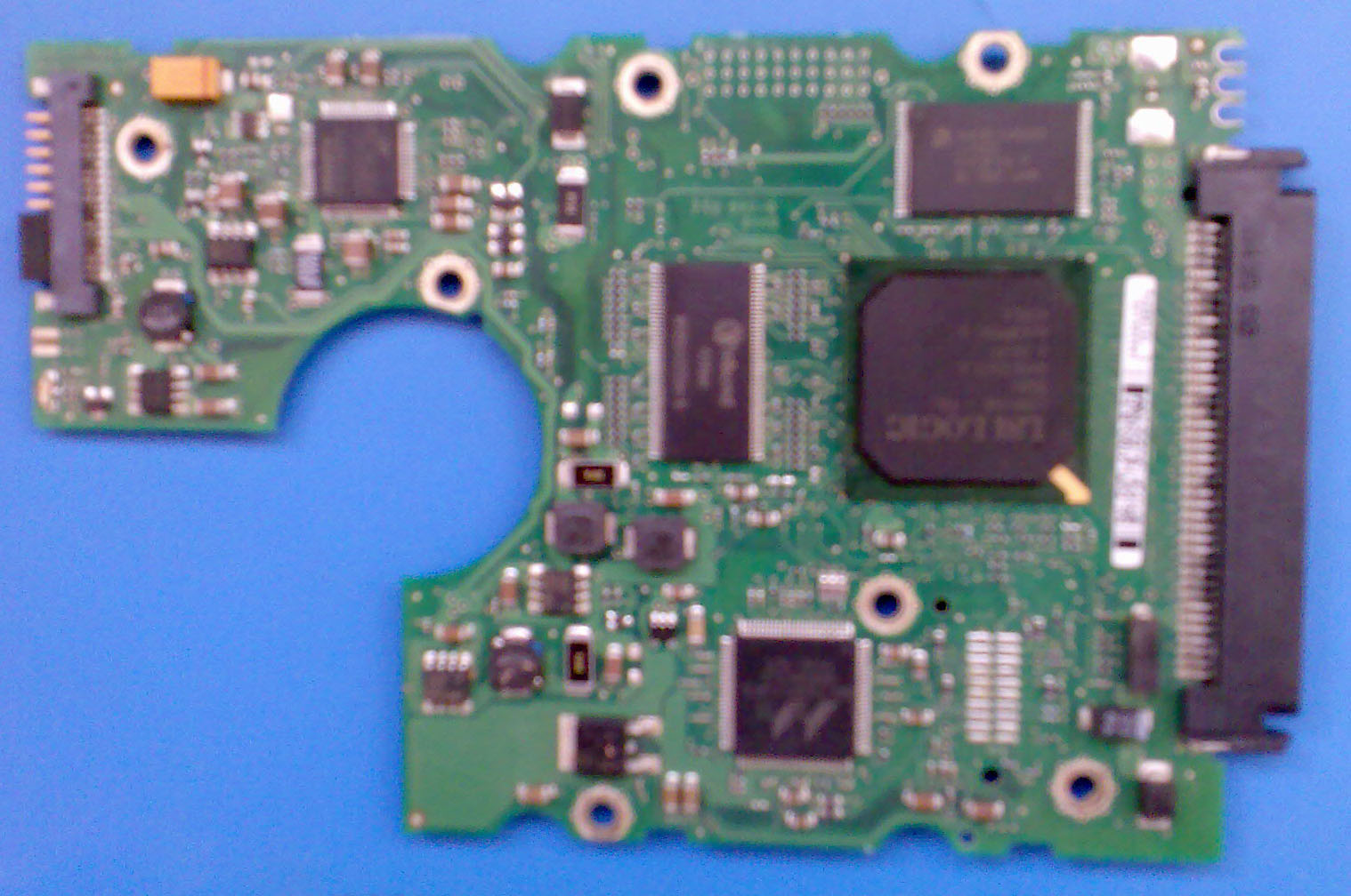

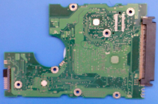

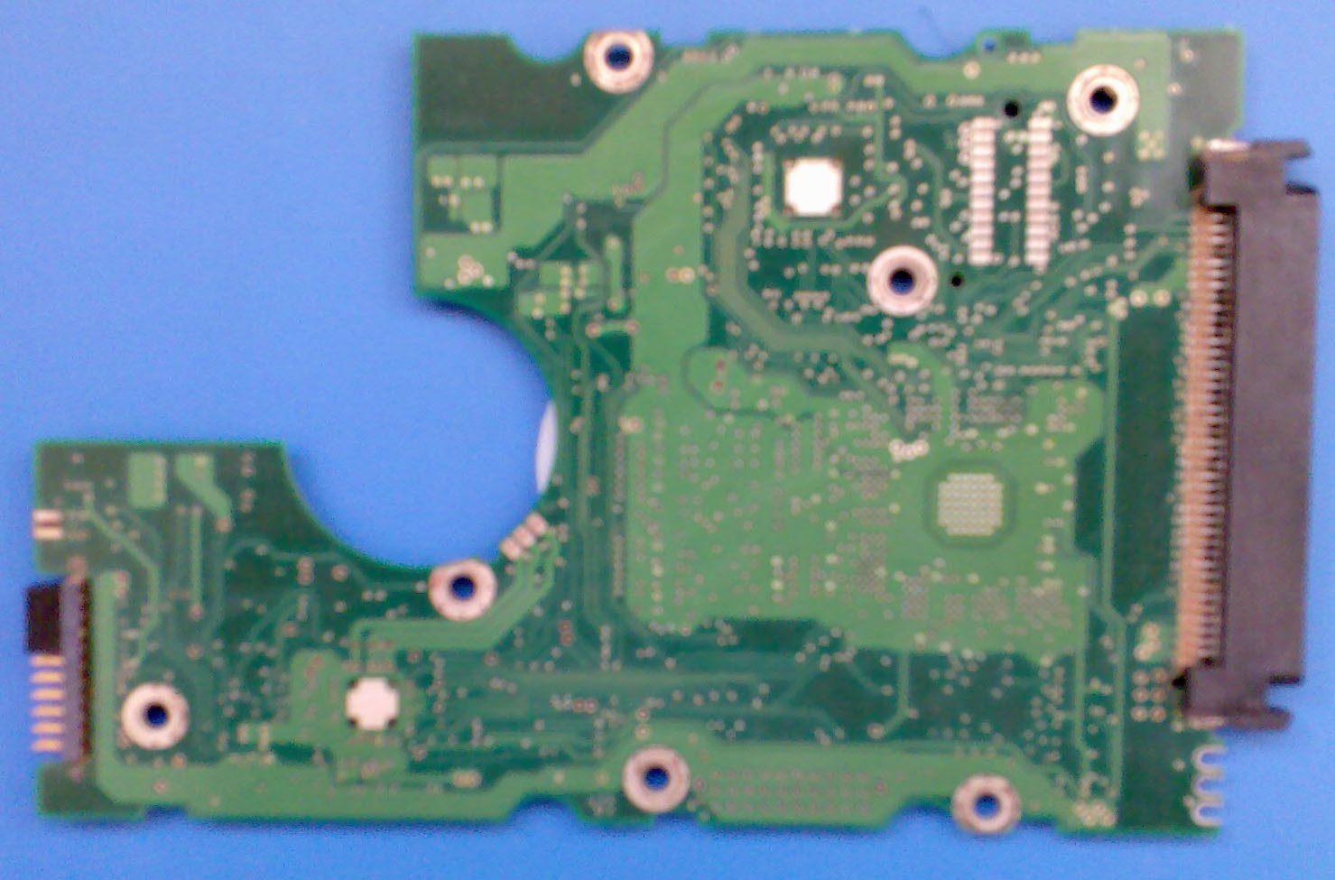

I have a 300 GB - 10000 RPM - WIDE ULTRA320 SCSI - HP MODEL:BD30088279 from a client.
The disk was underwater and lots of dirt in the PCB.
I remove the PCB and cleaned the contacts.
The PCB is naturally damage, because the computer was running when the water coming in.
Q. It's possible to change PCB and recover the data in this model and brand?
If not ... next step clean room.
Thanks in advance

 Post subject: Re: HP 300 GB - 10000 RPM - WIDE ULTRA320 SCSI
PostPosted: July 4th, 2010, 0:14
Posts: 17389
neuron wrote:
And in this drive which 8 legs circuit?
Upload a detailed photo.
Generally, 8-pin ICs that are situated near coils are MOSFETs, or FETKYs, or PWM controllers, ie parts of a switchmode DC-DC converter.
An EEPROM will have traces connecting to the MCU.
Thanks,
Please find attach the pics
Best regards,
Neuron
