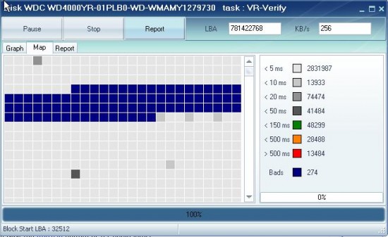

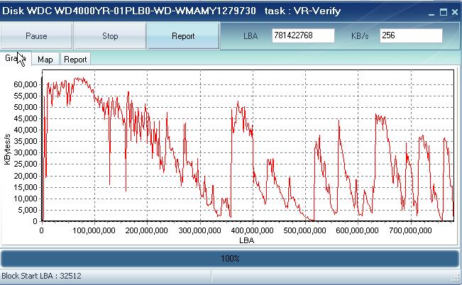

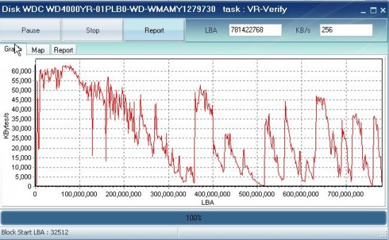

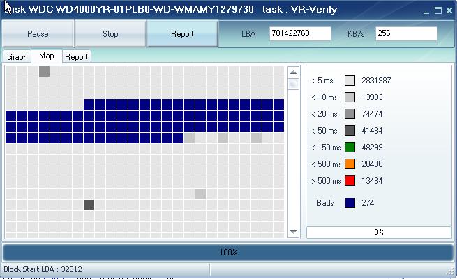

the report says:
open disk
test: VR-verify
Executing
Bad block found, start LBA : 32512
Bad block found, start LBA: etc (this continues for about 30 or 40 blocks, and then it says block start at...)
I'm not sure if this means that a bad block was found at 32512, or if a bad block was found at 1 and it trys to restart reading at 32512? I'm assuming the former, because on the map, it shows white blocks on LBA 0-20736, and the blue/bad blocks don't start until LBA 20992

Yo - Well you dont have damage on LBA 0 - and the fact that you did an entire verify scan and the hdd did not freeze of stop responding is good.
And the bads are somewhere on the beggining of the drive only.
Is the 274 Bads all in one area?
If yes - then use EASUS Partition manager for home users and create a new partition starting at 50GB upto ENDOF DRIVE- Leave the first 50GB empty with no partition no format just empty nothing. Apply the settings and format the new parition. You will be able to use the drive normaly (bear in mind that the drive has damage and could just fail without notice! dont the only copies of your firends wedding photos on there! - Back in the day working as a techi in computer shop i save allot of people buying new HDD this way and only a few failed - years later...)
If NO- then dont bother parititoning it at all - its possible the platters are degrading or bad quality and you will start to develop more and more bads until the drive stops. dont use it
Please remember that what you are doing is at your own risk and its NOT A FIX just a temporary workaround
