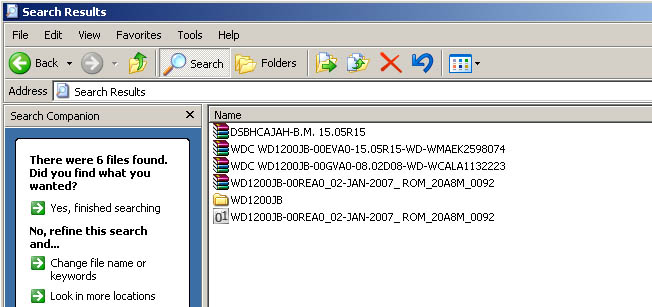

does this work with u?
let me know

Unfortunately not. On Your screenshot are firmwares from different models of WD.
I need one exactly matching firmware and ROM version.
Anyone has it?
