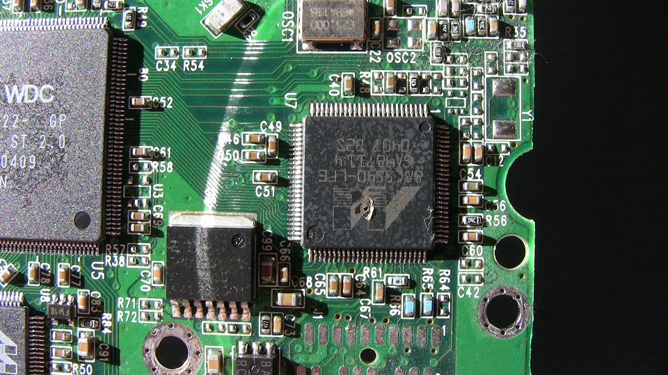

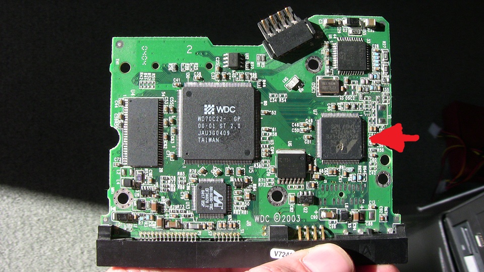

Hmmm one thing I thought about is to change that bigger chip....
anyone ever tried that?
the chip with the red arrow is the one that fried.
so I would replace this one with the one from the new PCB
 Post subject: Re: WD2000JD, got equal HDD and PCB
PostPosted: July 21st, 2010, 11:50
Joined: May 15th, 2010, 17:30
Posts: 66
Ok, the IC labeled U12 is the ROM. Get another identical board and swap this IC. But you may have grater problems than that. The Marvell IC with the smoke missing is the interface to the preamp so if it sacrificed itself and didn't let the preamp (inside the HDA) get fried you have a chance. But otherwise :(

So, just to get this right:
Nobody tried to replace the U7 chip?
(The fried one)
I know that would be harder, because this chip has more pins. But I think there would be no data necessary saved on that chip. So it might work?!
PostPosted: July 27th, 2010, 9:30
Posts: 3235
Location: USA
You already tried the new pcb with your old rom. There's no point.
