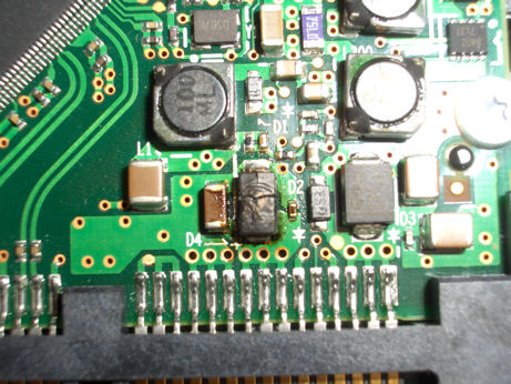

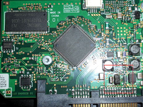

After testing my HDD with Hitachi Drive Fitness Test HDD, stopped working, check the PCB and i see that the diode D4 was burned.
It is possible to replace and if so someone knows that specifications have D4?

If you need to get data off of the drive you can remove it and extract the data to a new drive ASAP.
But I would not use this drive to hold data any more. That diode is the power protection for the drive; so when it's gone there is no more protection.

Search the forum for TVS for more info.

I removed the diode, and backup data, I found valuable information here on TVS ...
