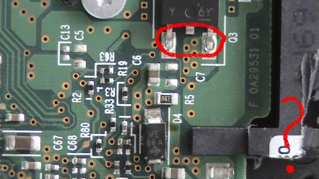

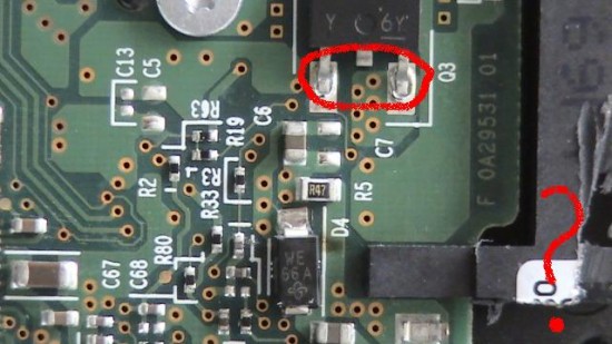

hi there, just wondering if this component is replaceable? the drive went pop with smoke and this is the only part i can find at fault.
If i were able to get on, and If i were able to solder it on could the drive work again?
what is the part called and where can they be bought from?
below is a picture of the part i need, it has WE 66 A on it.
thanks for any help.
jake

Its called a TVS.
Do some search about TVS on this forum and you'll quickly understand how to solve (if nothing else is damaged).

On the other hand, Q3 legs seems unsoldered and what the hell happened with the power connector?

hi there, thank you for the replies, sorry its taken me a while to get back on here.
pics not too brill, but ive looked at Q3 and it is still soldered on
ah yes, ahem. i had to carefully hack that bit off for it to fit into a usb sata enclosure which i used once then sold.
good work there guys, ill research the TVS.

thank you for the replies guys,
i'll look into the TVS thing
i checked q3, the pic want too good but it is still soldered
ah yea, ahem, i had to hack a chunk of plastic off to get the drive to mate up to a sata enclosure i had a while ago. didnt damage anything tho :D
cheers guys
jake

The WE marking code is used by Vishay / General Semiconductor for a bidirectional 5V TVS diode, p/n SMAJ5.0CA.
Normally these diodes are unidirectional.
Even more confusing, the same marking is used by Vishay / General Semiconductor for an SMZG(J)3791A 12V zener diode.
If you can upload a photo of the whole corner of the PCB, I believe that will confirm that it is a 5V diode.

I am starting to feel that the bad diode is the least of your problems... :?
