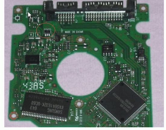

Please help me with p/n of 5pin Ic circled in Red.The location is u2
Thank you

Looks like u2 is ok
Thanks Terranova........
I swapped 5v and 12v.................that's how i killed this board
The fuse f1 was open.
I replace the fuse witha 0 ohm resistor and applied 5v alone on bare board.
At 5v input it is drawing about 1.0A.U1 is geeing hot canot touch.I assume it is fried
any opinion?
What will be a minimum requirement for a donor for a board with following spec
P/N 0A51843
MLC DA1753
MODEL HTS541610J9SA00
Board no 220 0A28613 01
WHITE LABEL 0A50426 DA1550A I5Y648 C4H8
Controller chip OA228644
MADE IN PHILIPINES(UNIT)
MADE IN CHINA (BOARD)
S/N SHG3UEPD
G8BC00037101

I think your PCB is cooked. Hopefully the adaptive info in U6 is not.

Thank jono
u6 is not getting hot
The regulator stepping down 5 to 3.3 so I hope only u1 is bad
Next step is swapping u6 to a good closely matched board
Any opnion about getting a closely matched board.What are the things to look for

0A50426 DA1550A

I am waiting for the donor board
this is what I ordered .The bad one is from 100gb drive.The board I am going to replace(with u6 from bad board assuming u6 is good) is from a 160gb drive
any one has any comments?
Your opinion appreciated
Model: HTS541616J9SA00

Got the donor board, swapped u6 and it worked
million thanks to this wonderful forum
Thanks also to Jono,terranova and networkpc
