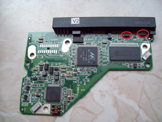

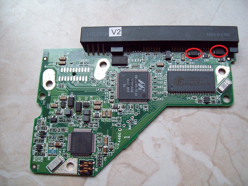

I have a similar problem. my "MyBook 500GB" external hard drive just stopped working a couple of days ago.
I was hoping that it would be a problem of the external casing and changed that already, but with no luck.
The curious thing about this error is, that the drive doesn't even start to spin. as soon as I turn the external drive "on", the Led starts flashing rather quickly but monotonously and nothing else happens. I assume there is something wrong with the power supply of the hdd, since I noticed another curious error. when I connected the drive to my desktop computer via the SATA connector on my mainboard, the whole thing went suddenly dead. no power! :shock: I had to disconnect the hdd from the mainboard and the whole computer from the power supply, after that it worked again.
Please let me know what I could do about that error. I have the feeling, that it might be a simple problem with the power supply of the pcb, but the actual data could still exist completely untouched on the drive.
I am somewhat of a noob in the field of data recovery, so please be gentle :D
the specifics of my drive are:
Modell: WD5000AAJS-32TKA0
Date: 10 Dec 2006
DCM: HANCNV2AA
WWN: 50014EE00009D25B
Product of Malaysia
PCB: 2061-701477-000 AB XS 4C04 03FQ 7 0005210 7215
pictures: http://www.rickreinhold.de/pics/102_1566.JPG, http://www.rickreinhold.de/pics/102_1567.JPG

its defo the pcb, i tried the board without the hdd attached,(i know stupid but it was broken so what the hell) it beeped and made the noices, i tried the hdd with a diff pcb even though it couldnt read the info and the hdd spun up no problem.

 Post subject: Re: WD5000AAJS
PostPosted: August 22nd, 2010, 19:46
Posts: 1151
hi Ritus,
check this diode.
