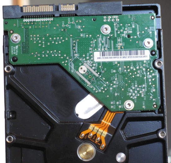

Dears all,
a dear friend of mine had a problem with an USB external Hard Disk from Packard Bell which decided to stop to work.
I checked that the Hard Disk is the one in the object and that it is not starting at all! I took one of my universal SATA adapter to check it but it was just lighting up the Power supply green LED and the Hard Disk red LED, for a duration of about 100ms and then off. After one second it tries again and repeats forever.
During this time I do not hear any sound about the motor so that I think it is not starting at all.
It seems to me that the problem is related to the power supply/motor.
Anybody knows if there is a possibility to repair it?
Thanks for any suggestion,
Carmine

If your board is similar to the following, then check TVS diodes D3 and D4, and zero-ohm resistors R67 and R64 near the SATA power connector. Also examine the SMOOTH motor controller chip.
http://www.powerbitsforum.be/e107_files ... FT0_wd.jpg
http://infdv.com/temp/wd10eads.jpg

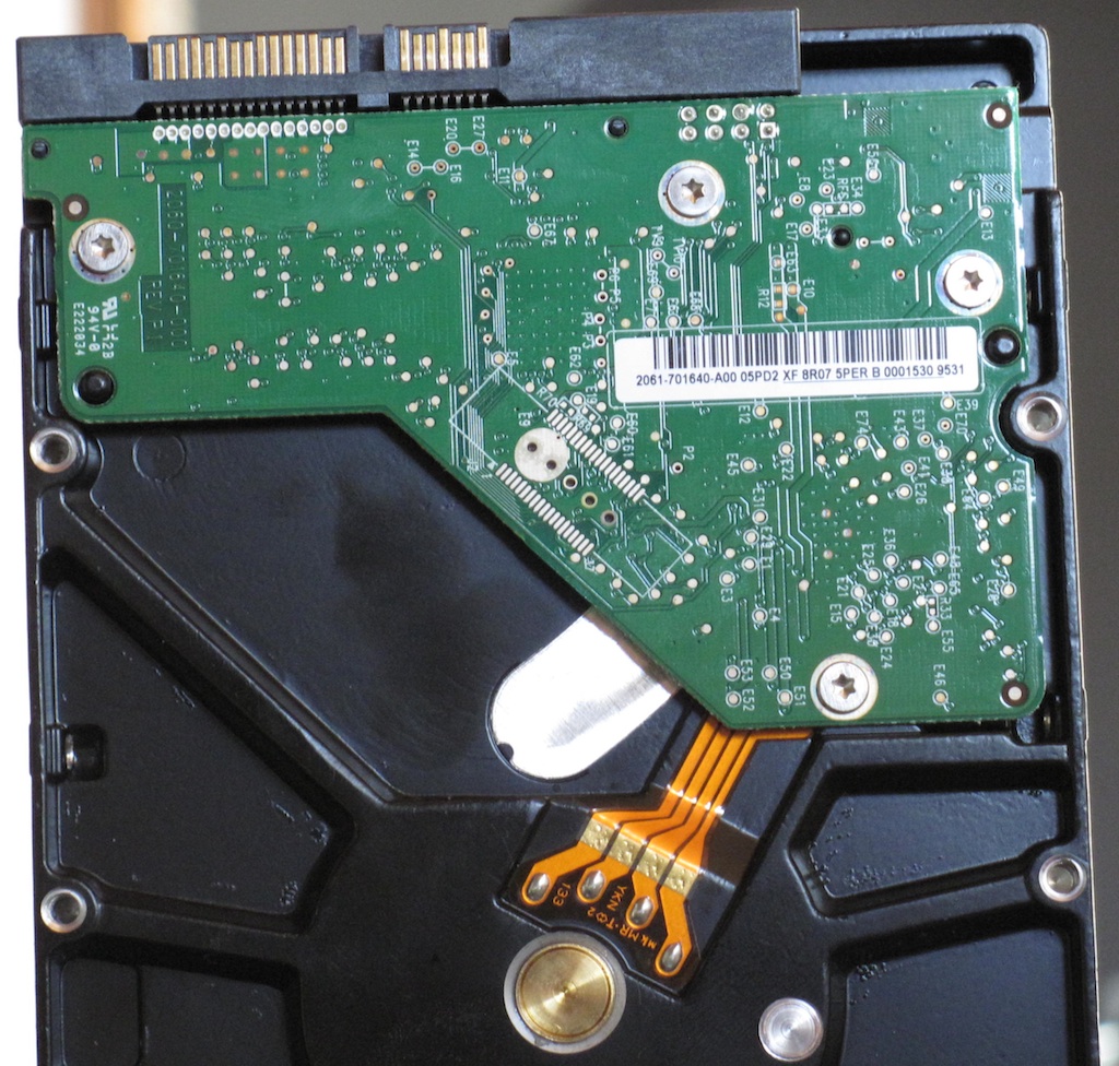

Dears all,
sorry for the delay. The attached picture is related to the printed circuit board.
Thanks for your co-operation.
Best wishes,
Carmine

A pic of the component side would be better 8)
Please unscrew the pcb and take a picture of the other side.
Regards/ Bosse
